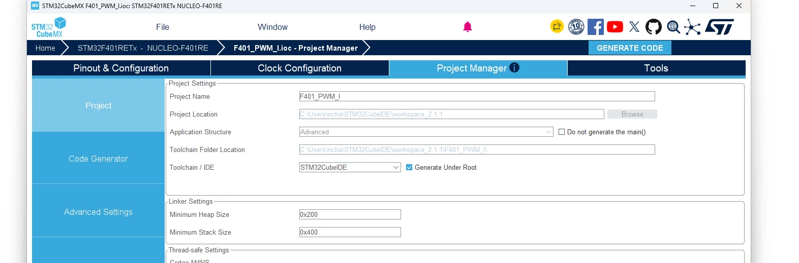

I bought an stm32f103c8t6 recently, and just wanted to write a simple test C/C++ program for it. It has been 3 days - I have tried multiple combinations of cubemx and cubeide versions and everytime there is the same issue - it just doesn’t let me build the imported project. On this site I found a similiar question on this topic and people said that the problem is caused by system username containing non-english characters. I changed my windows profile name to contain only english characters and the problem persists.
I am a bit lost
Here is a photo of my project, just generated by MX.
inside the project folder
And here is how it looks after i open it in the IDE
I have tried to manually set the nature to C/C++ but it doesnt solve the issue at all. it just make a small “C” appear over only the upper folder.

When you create new project for CUBEMX, first thing is select toolchain for STM32IDE,
When I forgot this, even change it later, still got trouble.
So first select  toolchain for STMCUBEIDE.
I hope this can help you.

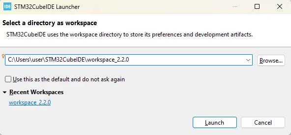

Here is how my path looked when I first published my question:

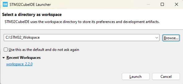

But, just in case, I changed it to this:
And my path to the project in CubeMX is now C:\STM32_Projects\test_project
I double-checked that the toolchain in mx is set to STM32CubeIDE.
I did exactly what you said, and the problem didn’t go away yet.

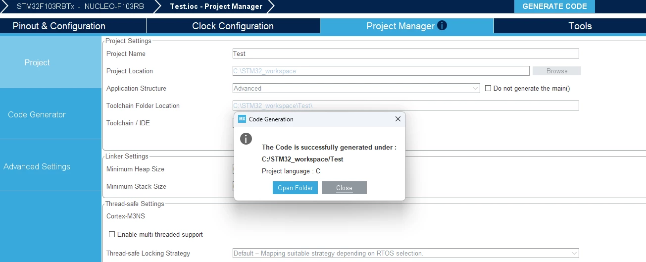

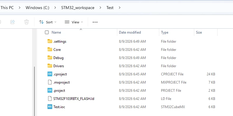

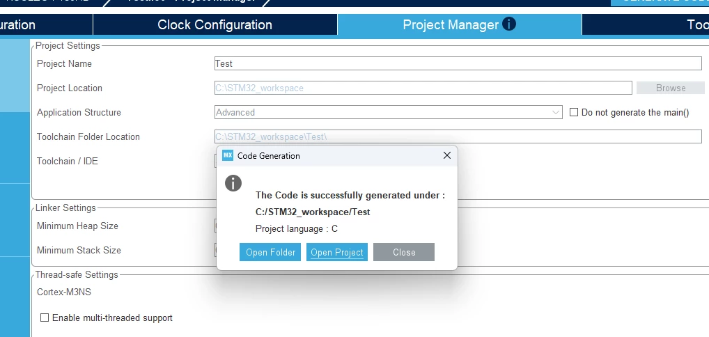

I try duplicate your process, in CUBEMX, there one step as attached:

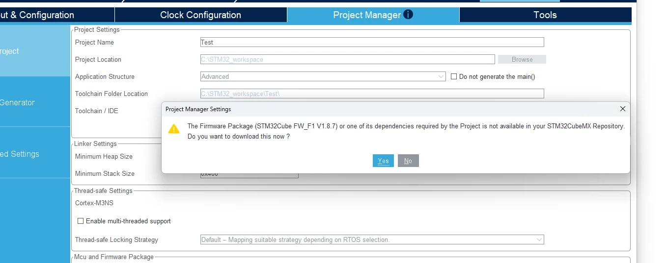

If you didn’t download the FW package, will show:
If you did download, after push “create code” button  , will show:

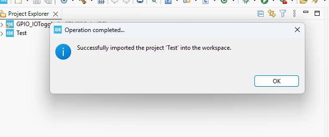

Then click Open project, windows 11 will open IDE for this project.

Attached MX create test project under :

My cubeIDE builds your project just fine, so I think the problem is connected with cubeMX.
About the last screenshot you sent, is this how the project supposed to look when MX creates it before importing to IDE? In my case, ld file, debug folder, .settings, .cproject, .project files are missing. But if i disable “generate under root”,  .settings and .project appear in a folder “stm32cubeide” inside the project folder, which still doesnt solve the issue, even if I move them into the main project folder.

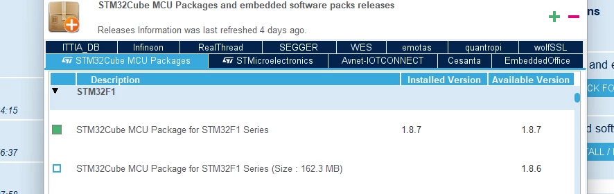

I think my FW 1 8 7 download may be corrupted. Can you send me yours from repository?
