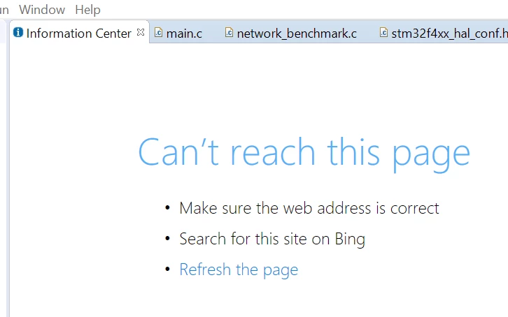

I agreed to STM32cubeIDE prompted upgrade to 1.0.2 this morning.
Very first screen it showed was Info Center - but it fails to "reach page".
Not off to a good start...

This can happen after the upgrade, you should be able to get it back by clicking the Home button in that view as shown in this screenshot:
We're hoping to find a fix for a future release.

@Markus GIRDLAND​ Thanks, "home" button works.
