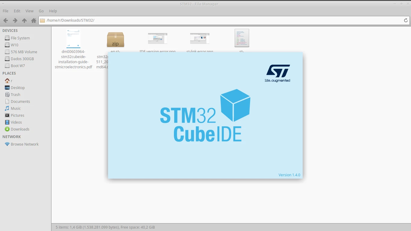

[BUG] The IDE version has not changed after being updated (LINUX)
After installing update 1.4.1 the splash field showing 1.4.0 has not changed.
It continues even after opening and closing several times.
In Windows I noticed that this occurs only once, then the number is corrected.
(I am reporting this, because if a simple version number has not been updated correctly, I wonder what else may be going on)

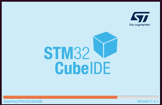

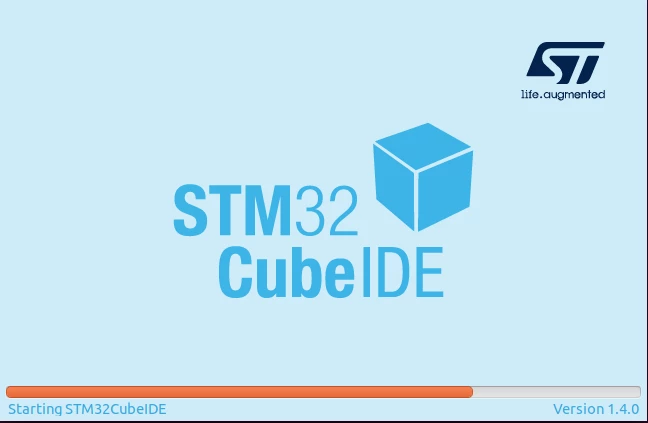

Do you use the restart button (Menu: File -> Restart) to close/open the CubeIDE?
Because just after the update if you still only use the restart button the splash field is not updated:
But then as soon as you close the CubeIDE through red cross or File -> Exit menu the splash field is updated:
Kind Regards
August 15, 2020
Thanks, I tried both restart and exit, but haven't updated the splash to 1.4.1 yet.
