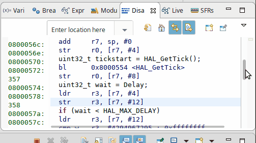

bug? The disassembly view in cube ide on linux doesn't scroll properly, the disassembly scrolls fine, but the addresses and opcodes are stuck until the window is resized or manually refreshed

I just tried to install it on my test Linux and I don't seem to be experiencing the same issue.
Could you provide some details about the distribution of Linux and how to recreate it?

Sure, hope it helps
Linux version is Linux Mint 19,1 Xfce 64-bit
4.15.0-48-generic #51-Ubuntu x86_64
I tried it on 2 PCs same linux distro, the problem appears on both of them, but not on windows.
How to reproduce it.
Install the debian package
Create a new project, I used stm32f746g discovery, using onboard stlink debugger
Create simple blinky project, or just the template code generated by the cubemx component
Enter debug mode, debug perspective, open disassembly view
Pause program execution
Scroll disassembly window using scrollbar
Result -> only the disassembly part of the window is scrolled, the address and opcodes and function offsets (if activated) are not scrolled, they get updated if the window is resized or manually updated, or when you scroll far enough sometime it gets update
I noticed this on linux only, the same test on windows worked fine.

I tried it again, this time on another Linux with Ubuntu. Now, I don't have the exact same setup as you with different board and a bit different Linux distribution, but I just can't seem to get the same problem. I tried scrolling, dragging the bar as you do in the gif and at different speeds at different sized windows but it always seemed to work.
Not sure what could be the problem and why I can't reproduce it. Do you experience this problem in any other view?
Also, if any other Linux user comes across this thread. Do you experience this as well?

I noticed this only in the disassembly view, but haven't used it much.
Maybe I could try it on some other distro, but all my PCs run some flavor of linux mint.
If you need more info I could check more things...
Also I forgot to say that this is on GDB server connection (not openOCD) (if it matters)
but I think this is somehow more of a java issue(?)
Here is my java version:
openjdk 11.0.2 2019-01-15
OpenJDK Runtime Environment (build 11.0.2+9-Ubuntu-3ubuntu118.04.3)
OpenJDK 64-Bit Server VM (build 11.0.2+9-Ubuntu-3ubuntu118.04.3, mixed mode, sharing)

Such effects may depend on the installed Java package.

I do have the same problem with the current Linux Mint 19.3.
java -version
openjdk version "11.0.7" 2020-04-14
OpenJDK Runtime Environment (build 11.0.7+10-post-Ubuntu-2ubuntu218.04)
OpenJDK 64-Bit Server VM (build 11.0.7+10-post-Ubuntu-2ubuntu218.04, mixed mode, sharing)
Which version is recommended for
STM32CubeIDE
Version: 1.2.0
Build: 5034_20200108_0926 (UTC)
I will try 1.3.0 soon.

I have tried
STM32CubeIDE
Version: 1.3.0
Build: 5720_20200220_1053 (UTC)
Same bug.
