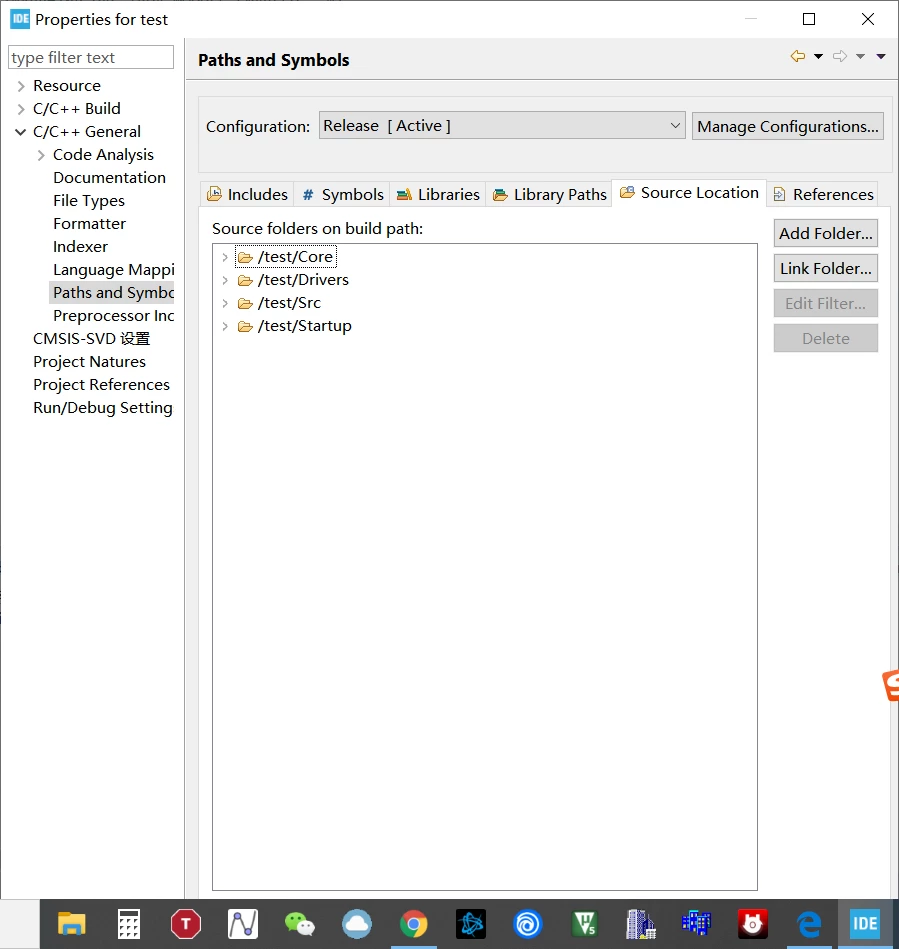

Hi,I met the same problem today.it happened when I chose ‘clean’ and then ‘build all’.
E:\20190602\test\Debug/../Startup/startup_stm32f103zetx.s:112: undefined reference to `SystemInit'
E:\20190602\test\Debug/../Startup/startup_stm32f103zetx.s:117: undefined reference to `main'
collect2.exe: error: ld returned 1 exit status
make: *** [makefile:41: test.elf] Error 1
"make -j8 all" terminated with exit code 2. Build might be incomplete.
and the error happened here:    line112 , startup_stm32f103zetx.s
bl SystemInit
 /* Call static constructors */
  bl main
When I delete the sentence"  bl SystemInit"and" bl main", the error is gone.
Zcj
Visitor II
June 9, 2019

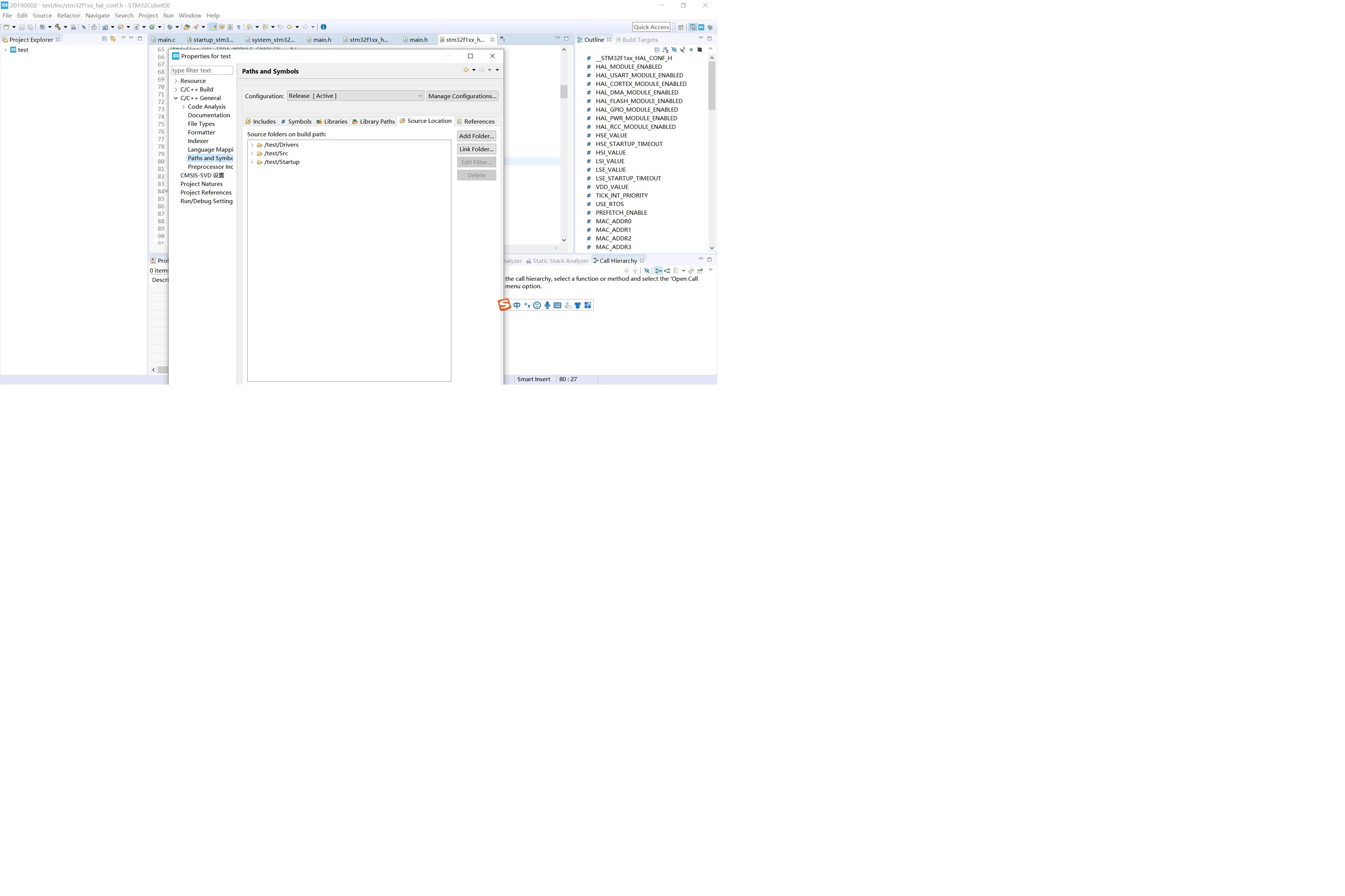

Hello, I found a solution to this bug.
​The reason for this error is after “clean�?, the directory of the project source file is incomplete, and the file path under "/test/core " is missing.After manually adding the path "/test/core", the problem is solved.0690X000008iOXrQAM.png0690X000008iOXmQAM.png

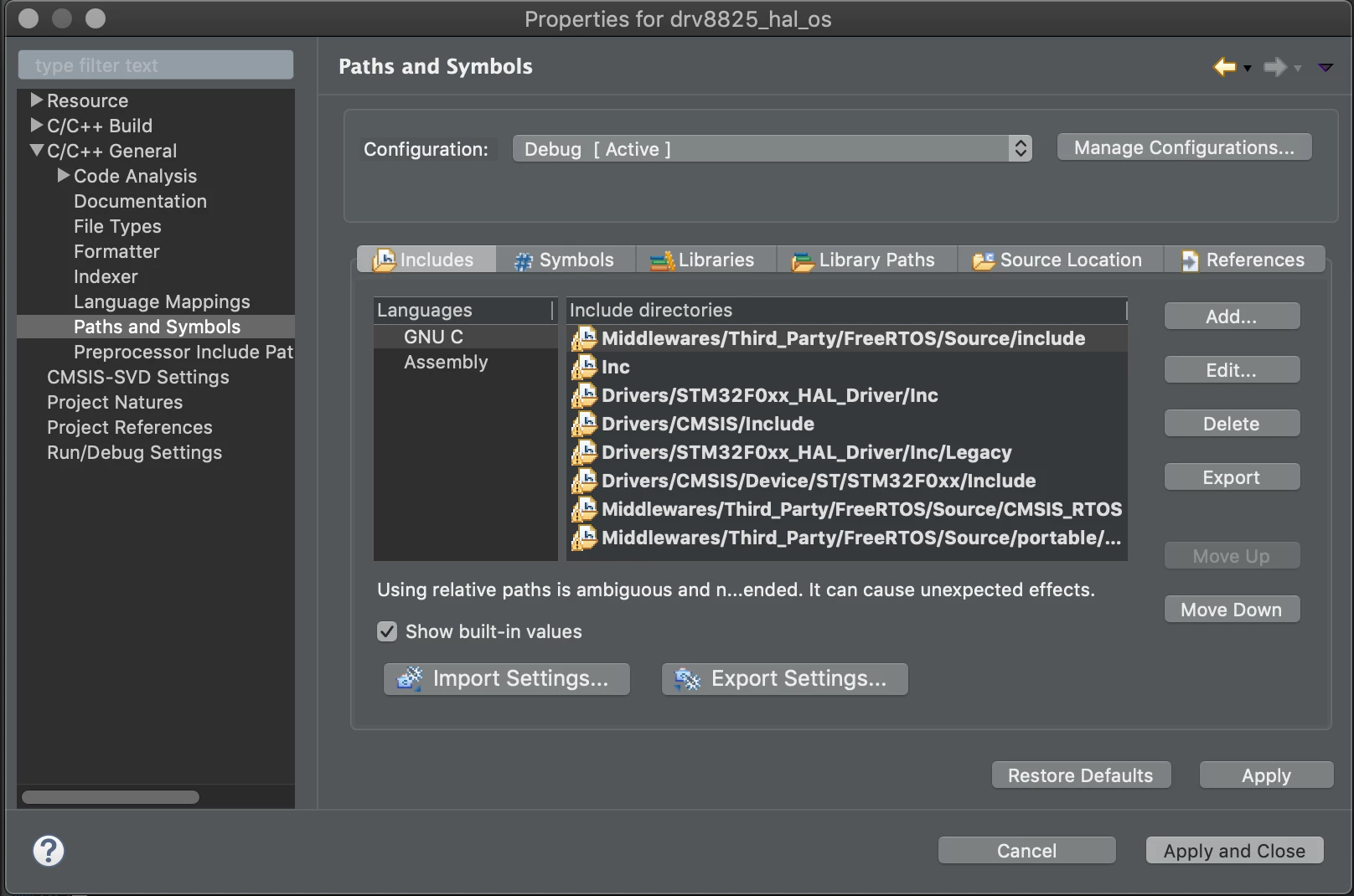

An unknown symptom of the IDE is that Paths and Symbols -> Includes settings are initialized.
This problem occurs when cleaning up the project or restarting the IDE.
The solution is to create the project first, export the configuration from Paths and Symbols -> Includes, and put it in the root of the project directory.
