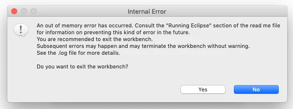

Bug report: STM32CubeIDE 1.12.1 for macOS runs out of memory on opening a workspace every time.
I'm using STM32CubeIDE 1.12.1 on macOS 10.14.6 (Mojave) on an intel i9 laptop with 32GB of RAM.
On startup or changing workspaces I get a message informing me that Eclipse has run out of memory.
If I dismiss this message, I get a second message (both attached), but IDE works normally.
I have not seen this problem until I updated to 1.12.1.
Not a stopper, just annoying.

    Is the .log file mentioned in the message available, and/or enlightening?

    (after fighting with an issue not being able to login to this server for the last couple of weeks) There is no .log file. I couldn't believe it. Kinda amateur hour, but anyway.
    Today CubeIDE had 1.13.0 available, so I updated and the out of memory error is gone. But the update, and updated firmware file for L4, completely borked my project and a simple printf goes to a fatal error without calling _write, and if I create a new project that just uses the same UART and has the same _write function, it works like a charm. It's a hot mess.

    If there's no log file: open a terminal and copy there the command line that starts CuibeIDE (or run it in a Terminal).  Will it spew something to stdout/stderr?
