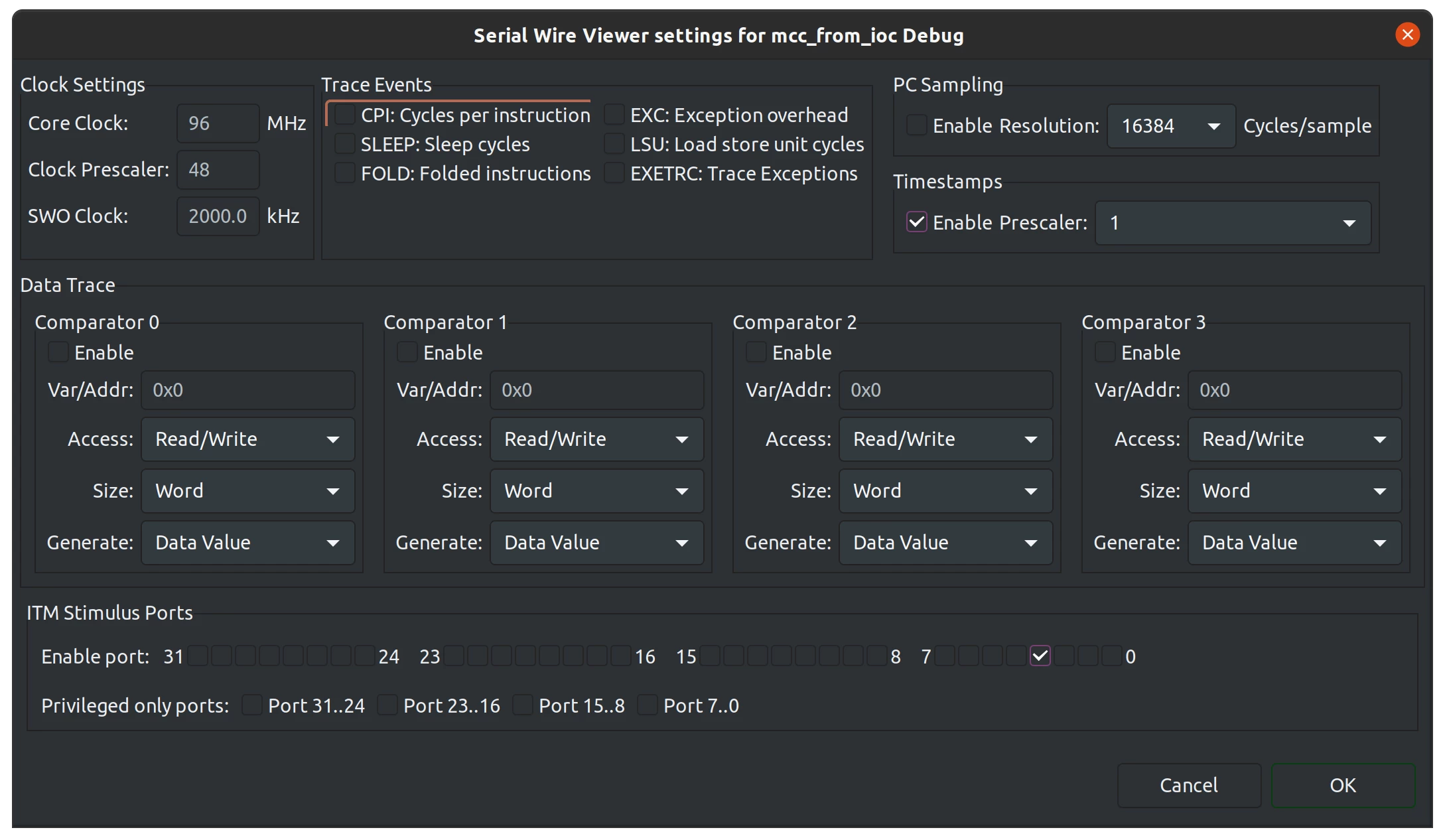

Here's an example ITM configuration with port 3 enabled:

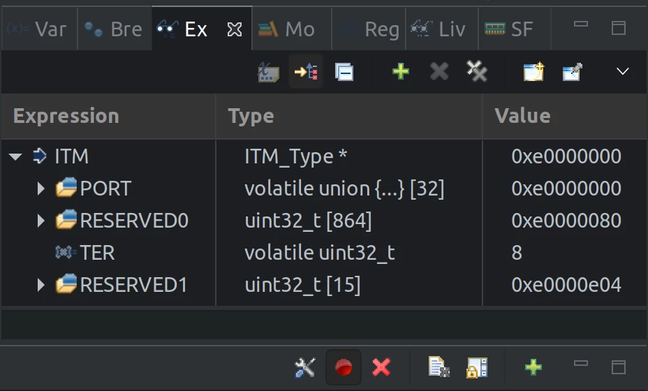

When tracing is enabled in the STM32CubeIDE "SWV ITM Data Console" (click on red circle to "Start Trace"), the bits in the ITM->TER register are set as expected. In this case, value 8 indicates that port 3 is enabled:

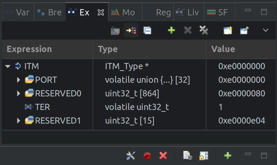

But when tracing is disabled, the bits in the ITM->TER register are set to an unexpected (and annoying) default value of 1. This indicates that port 0 is enabled, which is definitely undesired.
This is problematic for common ITM logging code, which checks if the port is enabled before writing to it.

A workaround is to configure an additional dummy port (port 2 in this case) to act as a flag for controlling whether to enter the printing loop. That way, when tracing is disabled, at least the dummy port is cleared, so the code can avoid the loop.
 // Check that ITM is enabled and ports 0 and 2 (dummy port) are enabled
 if ((ITM->TCR & ITM_TCR_ITMENA_Msk) && (ITM->TER & (1 << 0)) && (ITM->TER & (1 << 2)))
