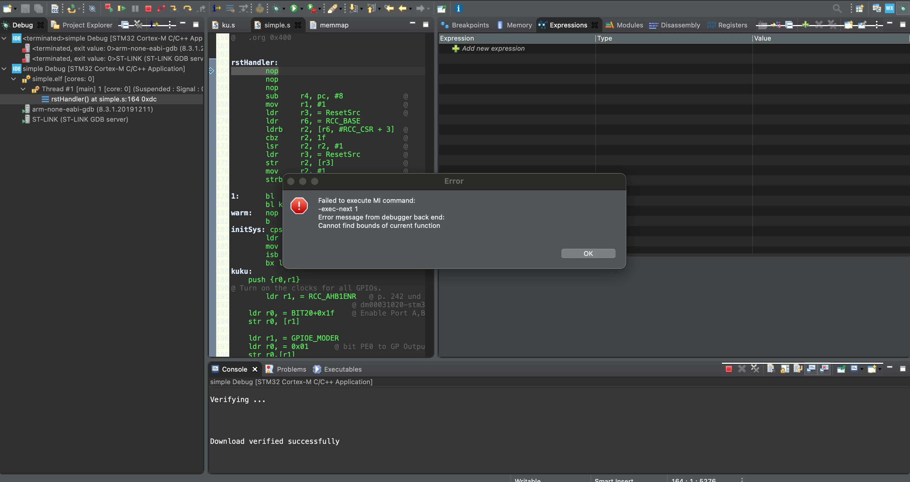

0693W00000BZaqlQAD.pngThanks Markus.
I unchecked Resume in the Debug Configuration Tab. The program stops at rstHandler (Reset vector location). There is no explicit BP set there.

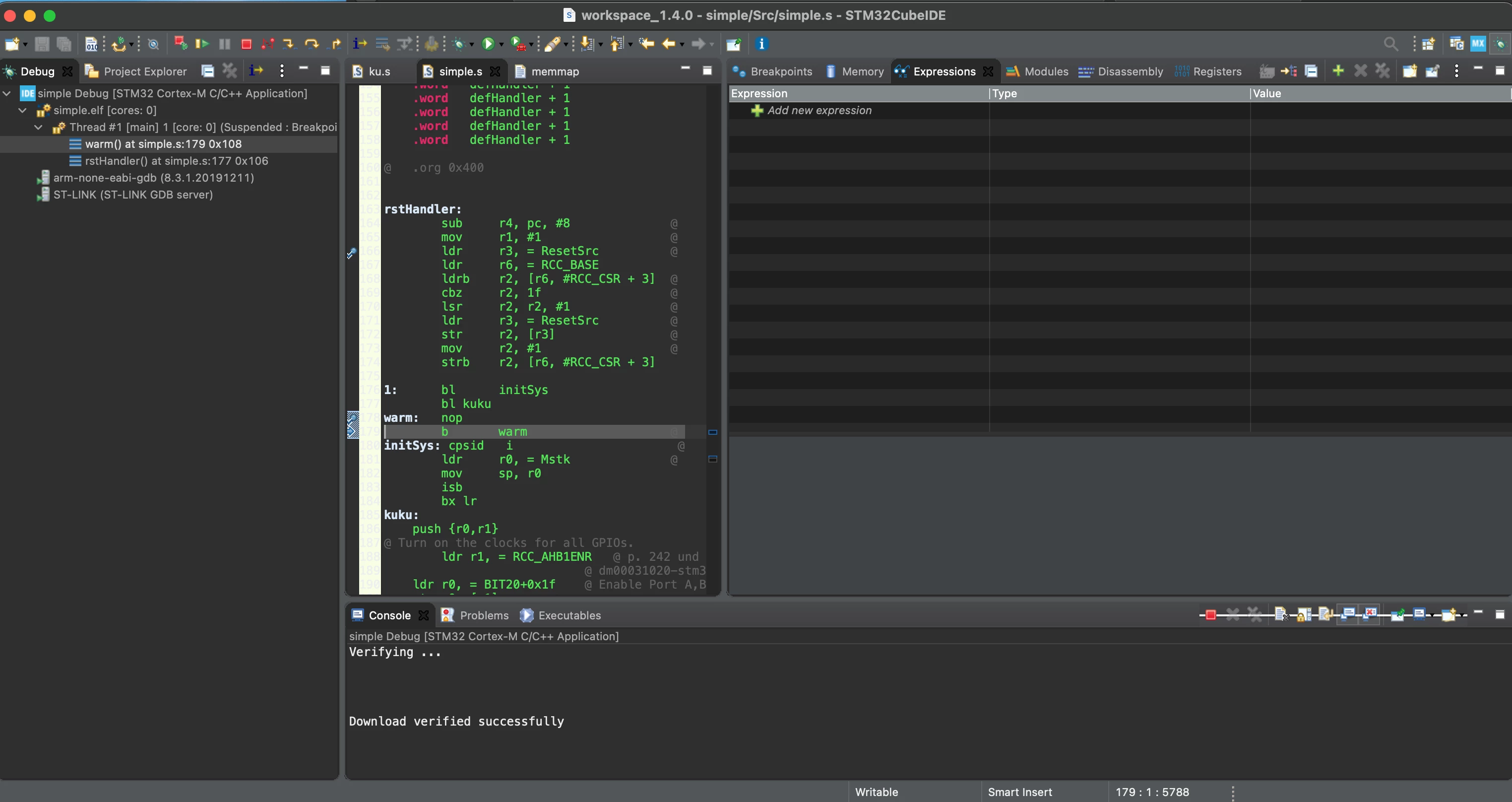

I reverted to "Resume" ticked on again.
This time the first breakpoint is hit right on. Setting then another breakpoint further down (see screenshot) at "warm: nop" you can see the BP arrow being one off.
So the problem persists.

Yes, I should have mentioned it in my OP. Indeed, when setting the BP in the disassembly view, it is set correctly and the arrow stops right on the set BP symbol.
