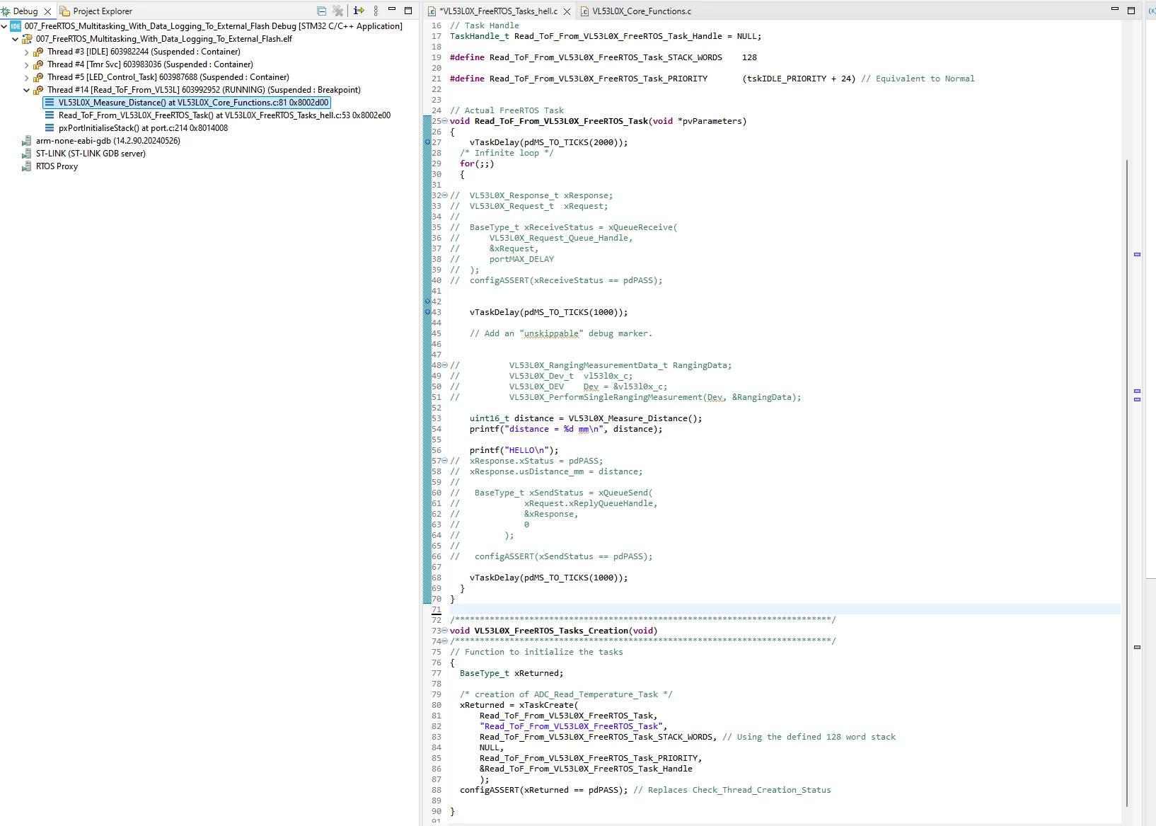

Weird things are happening.

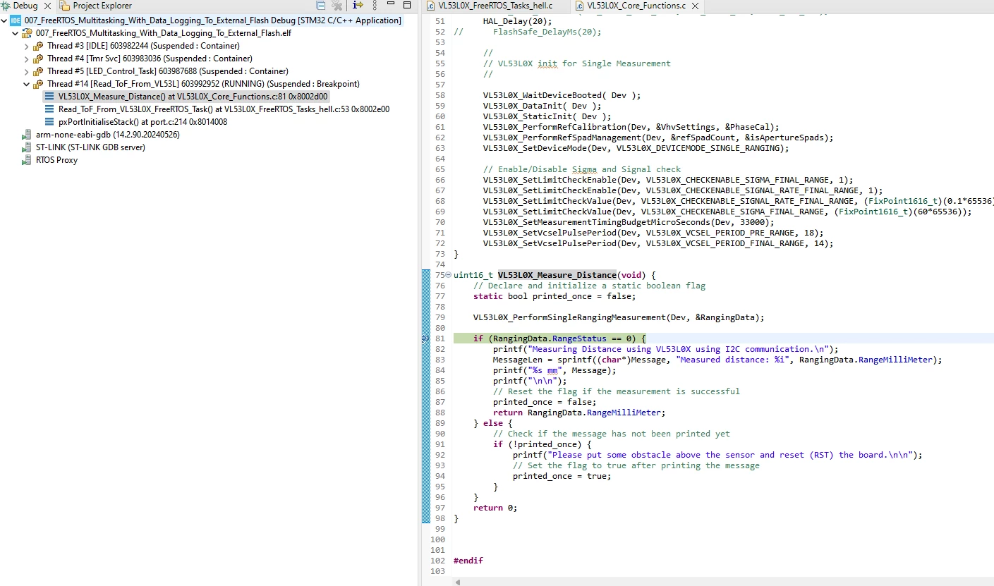

The breakpoint  i set in the void Read_ToF_From_VL53L0X_FreeRTOS_Task(void *pvParameters) task is not getting hit
this task calls VL53L0X_Measure_Distance function in which i set a breakpoint which is working ok !

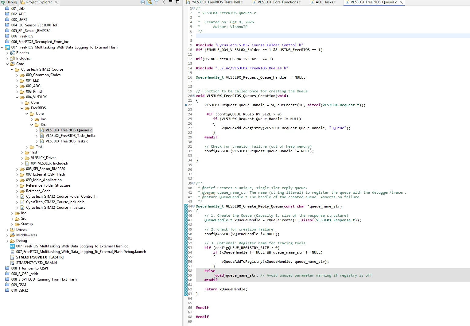

also i put another breakpoint in the file VL53L0X_FreeRTOS_Queues.c which is called upon initialization
this is also not getting hit

The tasks which are not getting hit by the breakpoint are working properly i am getting its outputs.

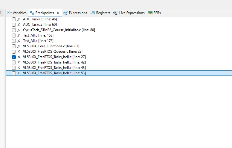

What device? The number of hardware breakpoints is limited. If you try to set too many, you should get a message about it.
Consider clearing all breakpoints, verifying that none are set in the Breakpoints tab, then setting the one you want to see if it will work.

STM32H750VBT6
i also tried to set only the breakpoints in the task Read_ToF_From_VL53L0X_FreeRTOS_Task  still not working

vishnu_illikkalAuthorBest answer
Oct 10, 2025 3:58 AM UTC
Today I tried the same code in a new project! and the breakpoint worked correctly.
So i guess some weird configuration error happened in the old project.
Note that i haven't manually changed any config in my knowledge.
If there were any shortcut keys i don't know about then and also if I accidently pressed some.
