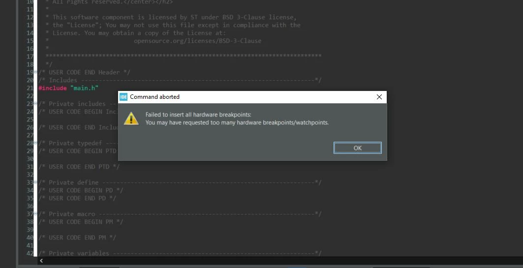

Break-point issues on STM32G030F6P6

When I try to upload to my STM32G030F6P6 I get the following error and sometimes I get the "Command Aborted" message attached in the picture.
I tried resetting my workspace too. But still I get this error.0693W00000GY7yjQAD.jpg
Erasing internal memory sectors [0 2]
Error: failed to erase memory
handle_vCont_c, Failed continue thread
2 replies
November 19, 2021
Can you select Run -> Remove All Breakpoints or is it grayed out? If you can, does it resolve the issue?

It is grayed out :(
I am just setting the Serial Wire in the configurator and uploading the generated code. There isn't even a single line I typed
