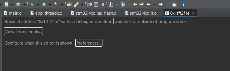

Break at address "0x1fff2f1e" with no debug information available
I am trying to program a stm32l451cet6 microcontroller. My code works perfectly fine for 5-6 debug sessions. After a few debug sessions, this warning pops up with a different address for every hardware I use.Screenshot 2025-01-28 190427.png
When this break at address pops up, my code stops working. I tried debugging and found there was no break point at any line of the code. Why is this break even popping up?

It can start in ROM if the FLASH is erased at some point in the reset, startup and erase cycle.
BOOT0 = LOW should be adequate to start viable FLASH code at power up.
Make sure SCB->VTOR points at the FLASH vector table, should be handled in SystemInit()

You're in the system memory. Few possibilities:
  • Is BOOT0 tied low?
  • Is the vector table set correctly (look at SCB->VTOR)

The BOOT0 pin is connected to GND. Is this a problem? Should I connect it to VCC or leave it hanging?
Jan 30, 2025 2:31 PM UTC
BOOT0 should be grounded or pulled to ground.
