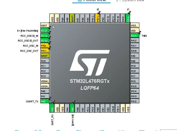

I recently purchased a NUCLEO L476RG and originally was able to upload code but now it no longer seems to work.

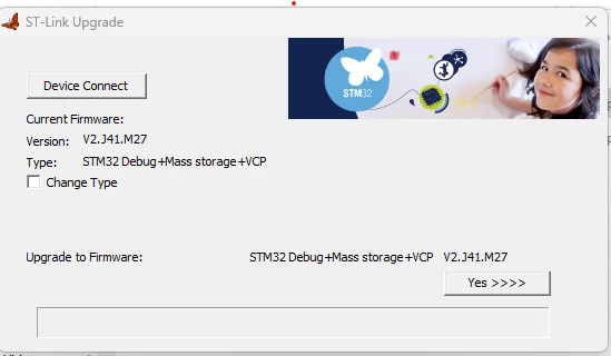

Here is the current firmware version:
Pinout is here:

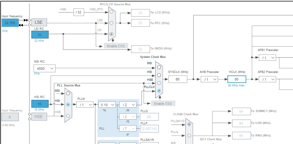

Clock configuration:
Not quite sure what the issue is here, running the project under release and build all results in zero warnings or errors yet the led does not change the blinking speed regardless of what I set the delay to.

Tesla DeLorean
Guru
March 26, 2023
HAL_Delay() takes milliseconds.
5000 seconds, 1.4 hours?
Delay for 500 ms
DRicc.2
DRicc.2Author
March 26, 2023
Tried that along with setting the delay to 5000 milliseconds, doesn't seem to do anything, no errors or warnings, the led was blinking previously but now the speed isn't changing, its still only blinking every other second.

gbm
March 27, 2023
Looks like your problem is not with the code but rather is related to the MCU Flash programming. Watch the messages displayed in the console panel at the bottom of CubeIDE window while you try to program the new firmware into Flash. If ST-Link cannot connect to the MCU, maybe try to edit debug configuration to reduce SWCLK frequency to approx. 1 MHz and change the Reset setting to Normal/None or Hardware reset.
My STM32 stuff on github - compact USB device stack and more: https://github.com/gbm-ii/gbmUSBdevice
DRicc.2
DRicc.2Author
March 31, 2023
Where would I find the reset setting for hardware reset? The SWCLK I was able to change to 1MHz but I'm not sure where the other setting is.
