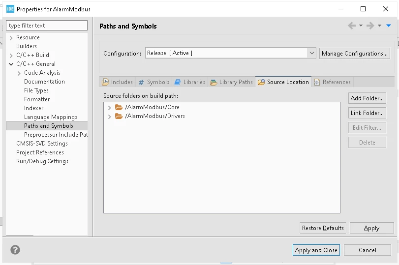

sbay.1
Visitor II
November 16, 2020
if output compiler error duplicate function Check On source.mk it any list double file
goto project properties
delete any list folder , this work for me
