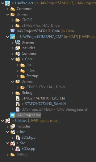

I am working on an STM32 project that utilizes both the CM7 and CM4 cores. I have structured my project to include a static library named Utilities, where I'm facing some challenges with accessing the HAL functionality.
Project Structure:
Utilities
├── .settings
├── Debug
├── Inc
│ └── SOS.hpp
└── Src
 └── SOS.cpp

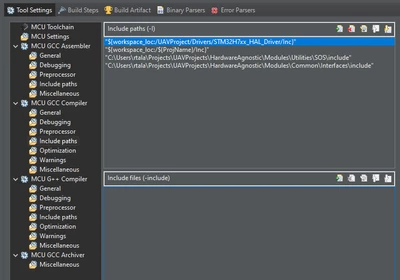

Here are the compilation errors. I have read "UM2609 Section 2.1.2.2, Creating a new STM32 static library project." My library has no visibility on on those functions or definition for the port or pins. I see how they are used in my dual core executable. But giving my library visibility on them is my problem. Further below I will include screen shots of my C/C++ Build Settings. Maybe I'm missing something there.

Here is my project structure and include build settings.
I have tried including stm32h7xx_hal_gpio.h and stm32h747xx.h in SOS.cpp to get visibility on those definitions but that generates a ton of new compilation errors that look like this.

The more I look at the problem I think it might be the need to specifically include certain stm*.h header files or some sort of special setup in my library project. If that is the case can you point me to the documentation that explains that or a sample project?

mƎALLEm
May 9, 2024
Instead of including stm32h7xx_hal_XXX.h or stm32h747xx.h, did you include stm32h7xx_hal.h:
#include "stm32h7xx_hal.h"
