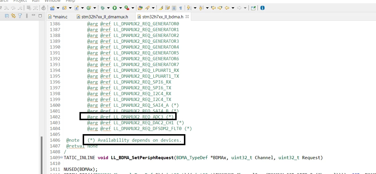

Data Sheet should indicate the H7xx devices having an ADC3
Will need to check later.​

I didn't fully understand what you were saying.

a) Not all H7 have an ADC3
b) I will look at the DS/RM when I'm at a computer
Part looks to have ADC3 on AHB4, and the BDMA should be able to use it provided the destination buffer is in the SRAM4 (D3 Domain)

> I was wondering if bdma can be used with adc3.
Yes. BDMA is hooked up to DMAMUX2 per the reference manual. DMAMUX2 is connected to ADC3 through requests 26/27 (ADC3_IT/ADC3_AWD). See "17.3.3 DMAMUX2 mapping".
