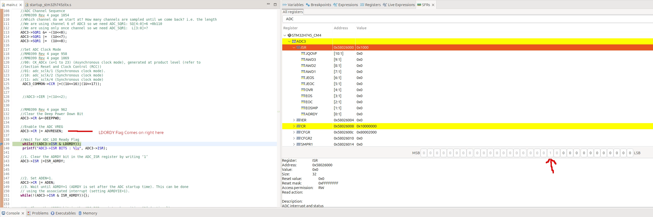

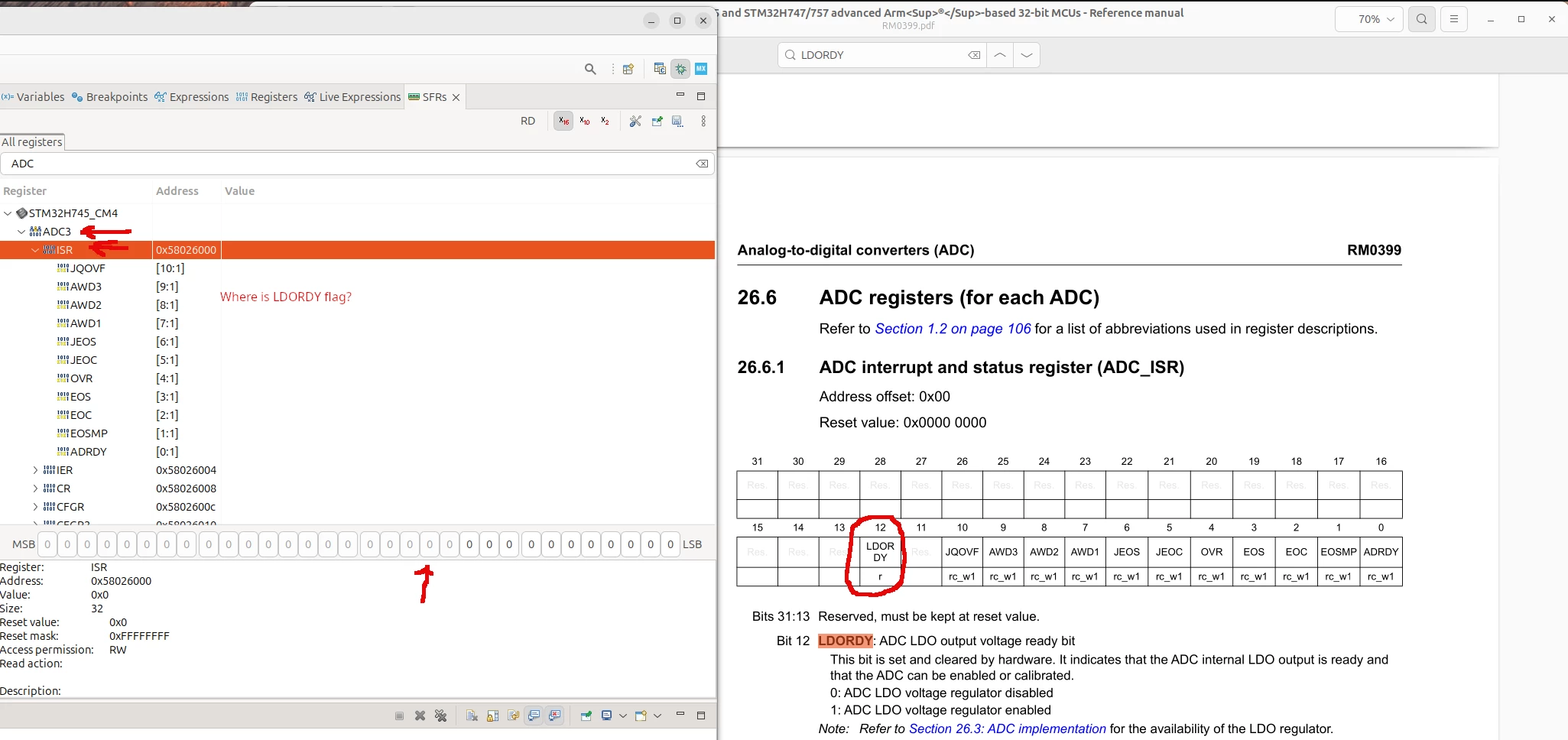

zirogravity
Nov 28, 2024 12:58 AM UTC
I am just noticing that the LDORDY bit field is not shown in the SFR debug view for STM32CubeIDE. Bit 12 is being set correctly. This should be OK I suppose and unrelated to why my code does not get past a reset/single read?stm32LDORDYMarkUp.png

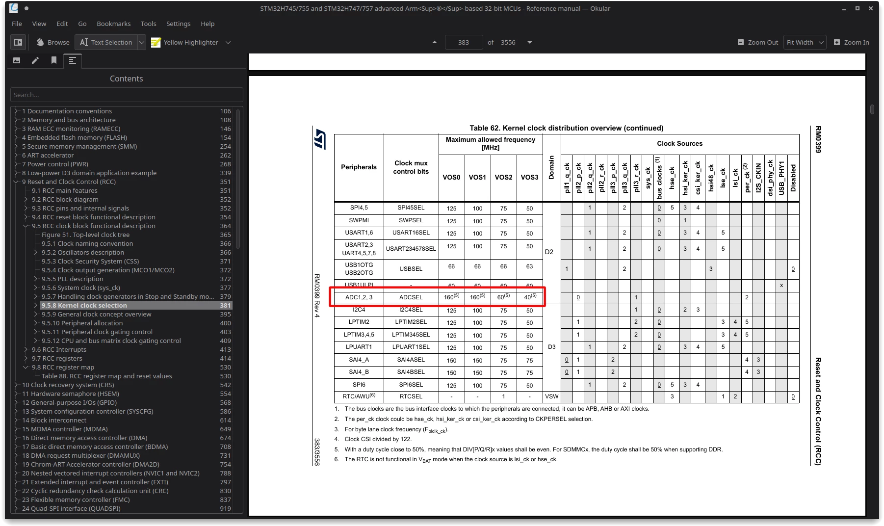

Hello @zirogravity !
NOTE
You have written, you use the default RCC/PWR setup. So the peripheral kernel clock is 64MHz.
The maximum allowed frequency for the ADC's is 40MHz (VOS3), 60MHz (VOS2) and 160MHz (VOS1 and VOS0).  Have you changed the voltage scaling (VOS) to VOS1 with the power controller (PWR)? The default is VOS3.
ADC maximum allowed frequencyADC maximum allowed frequency

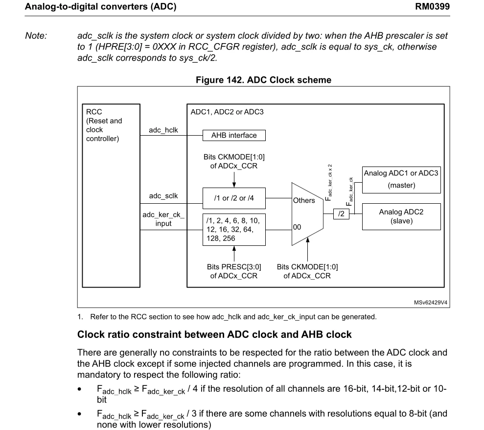

zirogravity
Nov 28, 2024 4:08 PM UTC
Hi @krotti42 ,
Thank you for this insight. I will have a look today, make some changes, and report back. Perhaps I misunderstood but I thought when CKMODE[1:0] is set to 01 or 11 the prescaler would be either 2 or 4 which gets further divided by 2 according to Figure 142 ADC Clock Scheme diagram. The information shared is very helpful and I will test out. I have not changed or set VOS at all.
