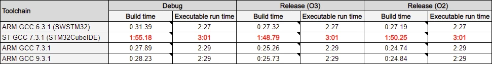

I am preparing for migration from SWSTM32 V2.4 (GCC 6.3.1) to STM32CubeIDE V1.4 (GCC 7.3.1).
During testing, I have noticed very significant performance issues in both compile time and generated executable run time. Please see the attached table for my test results.
All tests were done using CMake and changing the compiler path, so there is no effect of different IDEs.
NOTE: I was not able to test the generic ARM toolchain bundled with STM32CubeIDE, due to it not being able to find a header <bits/c++config.h>. I, therefore, downloaded GCC 7.3.1 form ARM for this comparison.
Run times are in seconds.

I re-took the GCC 7.3.1 tests with the parallel build disabled and got the following results:
ARM GCC 7.3.1: 1:48.07
ST GCC 7.3.1: 8:28.49
The difference is staggering...

Thank you for the answer. I have tried a few things as suggested.
Building the above project on a Linux machine, I got identical results with ST GCC 7.3.1 and ARM GCC 7.3.1.
Back on Windows, I tried to build some different projects:
  • Another (smaller) project:
    • ST GCC: 31 s
    • ARM GCC: 12 s
  • TouchGFX Demonstration from CubeFW:
    • ST GCC: 65 s
    • ARM GCC: 42 s
The TouchGFX example does not appear to be impacted as much as our internal projects.

I think I got down to the bottom of this.
I was able to get the build time down to ~42 seconds, by making all the include paths absolute and removing almost all -I include path parameters from GCC build commands. I guess the long path support overhead is increasing with each include parameter.
By the way, the ARM GCC build time went down to about 20 seconds.
