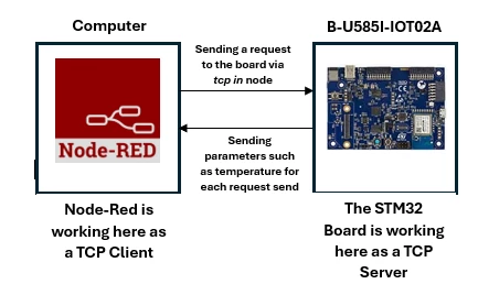

I'm currently working on a project involving an STM32 board (B-U585I-IOT02A). I would like to use this board as a TCP Server. Therefore, from the STM32CUBEIDE application, I had observed that there is an example project in which it is possible to render this board as a TCP Server (Nx_TCP_Echo_Server). However, my problem was that it only returns the value returned by the TCP Client. So, I wanted to modify this program so as to be able to retrieve the temperature parameters. So, I created a program based on an example (https://wiki.st.com/stm32mcu/wiki/STM32StepByStep:Step4_Sensors_usage). I wanted to combine these two programs to retrieve the temperature data.
To sum up, the diagram is as follows:

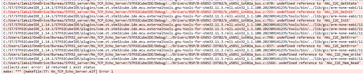

Unfortunately, I've encountered errors in the program's implementation. It gives me the following errors:

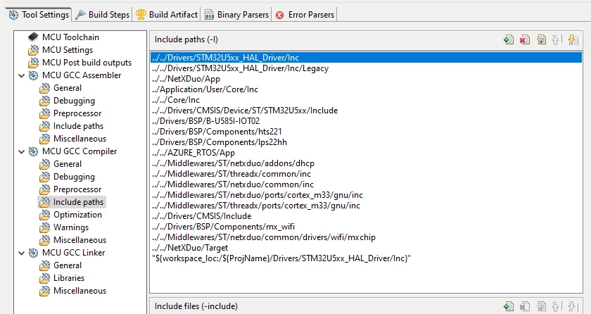

The project architecture is as follows:

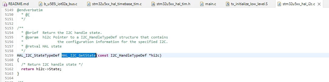

What I've noticed is that when I access the function where the error occurs (e.g. HAL_I2C_GetState), I'm able to access the .c file, as shown in the following image:

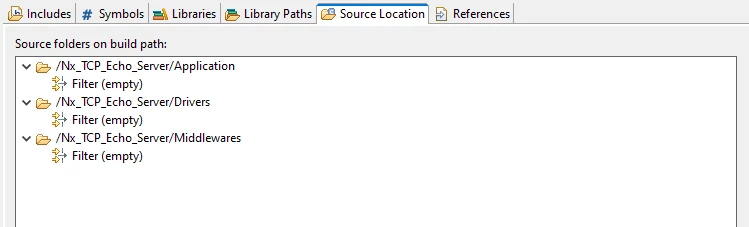

Other modifications include:
I don't really understand why I'm getting these errors, because when I ctrl + click on the function with the error, it opens the .c file with the appropriate function.
Would it be possible to help me solve this error?

    In project settings -> C/C++ General -> Paths and Symbols -> Source Location, ensure that the HAL library source code file path is in there.
    When you compile the project, ensure stm32_*_i2c.c is being compiled.
    In your *_hal_conf.h file, ensure the I2C module is being enabled.
