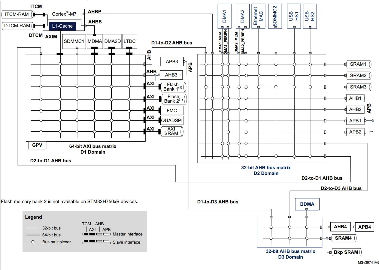

I am trying to add support for FTP support using CubeIDE.  In the Software Packs Component Selector, under Network NetXDuo> NetXDuo> there are several Addons that can be applied.  One that I am currently using is Addons Web Server and that is working.  However, I do not see a selection for FTP.  I do find in the software packs repo for STM32H7 (version 3.2.0), in the Middlewares/ST/netxduo/addons folder another folder called ftp.  This folder contains the nxd_ftp_server.c and nxd_ftp_server.h files I need to support ftp service.  If I add those files to my project, in the same place the web addons are kept, when I regen the project the files I added are taken away.  It seems like there should be several more options available in the Software Packs selection so CubeMx knows to add them or at least not take them away.
I guess for now, if have to put them in a safer location.  A little annoying.

    Copy the files in Middlewares...addons/ftp to a location that cubemx does not update.  Two solutions.  1) add folder to project root and put the files there, or 2) in my case I added them to the common Src and Inc folders.  That way i dont have update the project includes and source paths.  Then create the ftp instance.

    I finally found the problem and got everything working. The problem is that I connected the SD-Card to SDMMC1 which is in the D1 Domain. I had the AZRTOS system as static allocation and placed it in the address range of the D2 Domain. The SD driver cannot access anything in the D1 Domain under these conditions.
    To solve the problem, I simply moved everything belonging to the AZRTOS to the D1 Domain.
