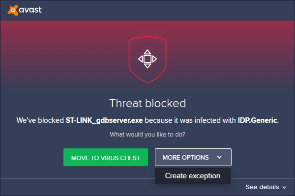

Avast virus checker tells me that the newly installed STM32CubeIDE is infected (see attached). What should I do?

I’ve sent the request to the developers to also sign the windows binaries for future releases which they say won’t be a problem for future releases because now the ST-LINK GDB server is built separately from the CubeIDE build, which wasn’t the case previously.
We didn’t sign the windows binaries before because they were just a step in the build process and the signing process needs to be done manually.
For now, I would create an exception to allow the file.
So to summarize: It will be fixed in future releases of CubeIDE.
