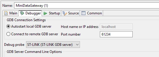

Hi
  I have been having issues in my STM32CubeIDE V1.13.1 , where the st-link couldnt be found. I finally found found the issue . In the below,  if I select  'AutoStart local GDB Server' , then I get the message 'st-link not found' . But if I run the GDB server manually, and select 'Connect to remote GDB Server' and set 'IP address' to my machine it works. Can someone let me know how I can get 'Autostart .. ' to work?
Many Thanks
Scott
Best Regards
Scott
    3 replies

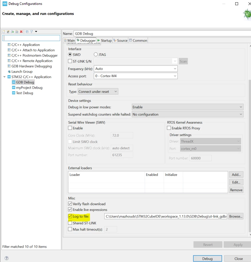

    Hello @SSmit.1313,
    Thank you for sharing the issue.
    Could you, please, provide :
    • GDB server log file by activating the option log to file as shown in the screenshot.
    • The used MCU
    Thanks,
    Souhaib.
    To give better visibility on the answered topics, please click on 'Best answer' on the reply which solved your issue or answered your question.

    Hi ,
     Many thanks for your reply.
    When I tick it, there is no log file created, just a message saying no st-link found, thats when I debug as  IDE, see below.
    When I debug as the .elf I get :
    "Error with command: gdb --version
    Cannot run program "gdb": Launching failed"
    Regards
    Scott

    Hi @SSmit.13
    Please try to update the firmware version and check debugger settings, or re-install ST-LINK server from this link : ST-LINK-SERVER - ST-LINK server software module - STMicroelectronics .
    Regards
    Souhaib
