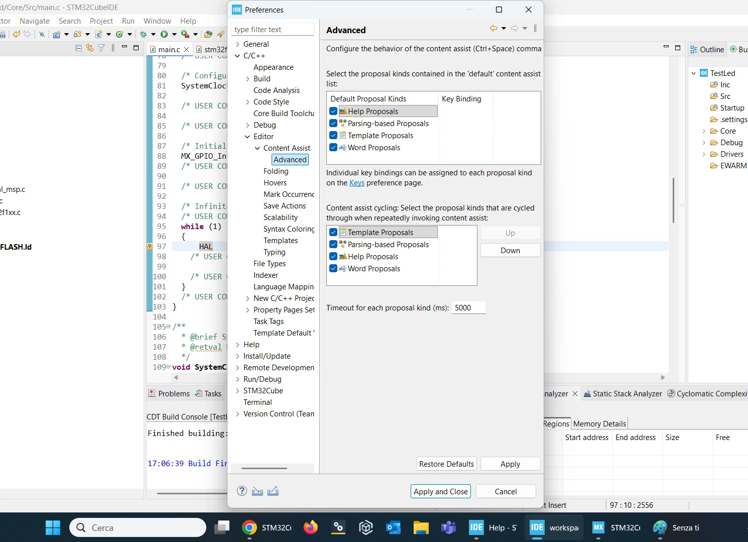

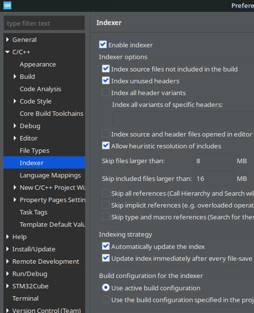

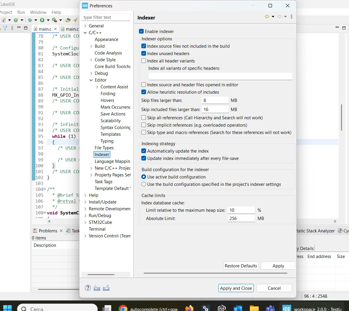

you had it working before ? IDE version ?
indexer enabled ?
Kram28Author
November 23, 2025
Idexer seams to be active.

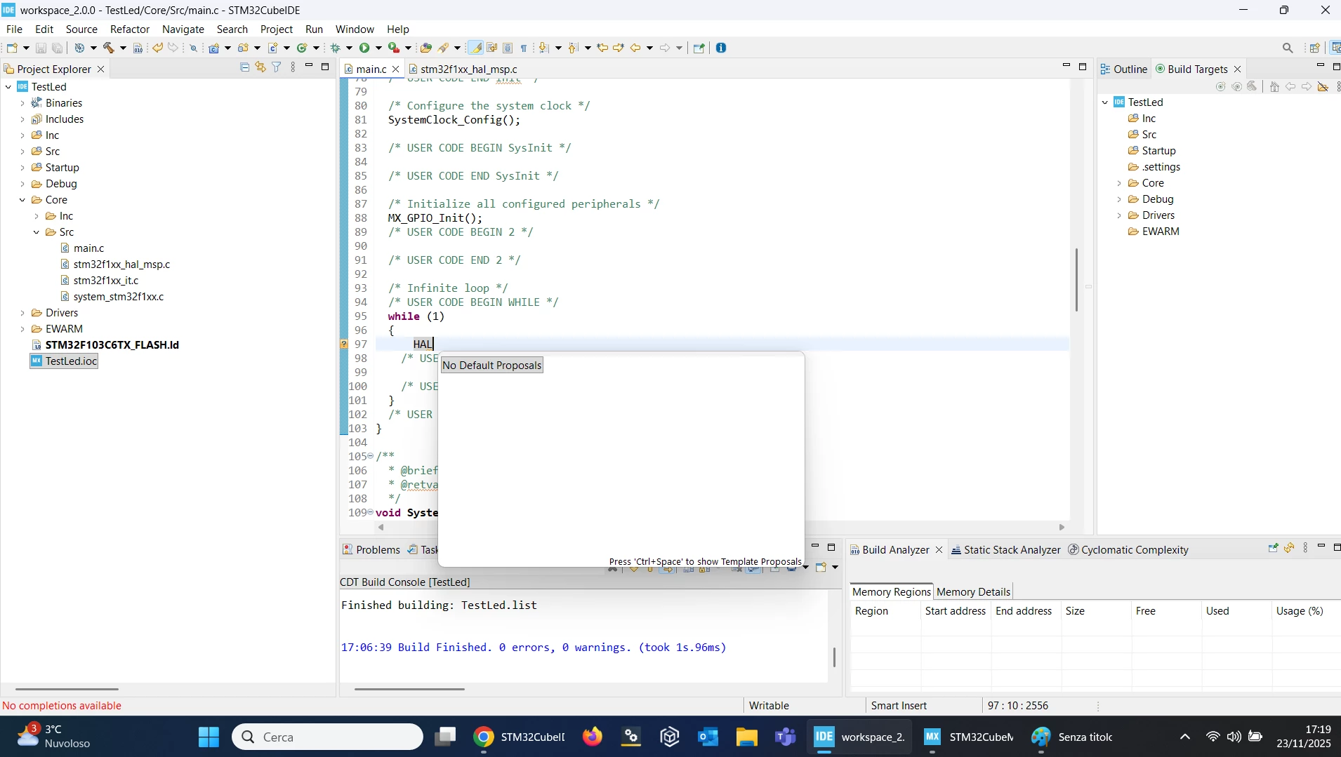

STM32CubeIDE
Version: 2.0.0
new installation
I generated files with cubeMX and in the same folder open a new project in cubeIDE.

Kram28Author
November 23, 2025
I uninstall v 2.0 and install v 1.19 now works fine thanks
