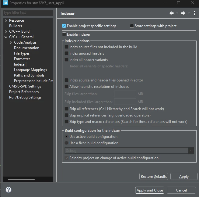

TL;DR: Right click your project in Project Explorer, click Properties > C/C++ General > Indexer > Enable Indexer if option is not checked.

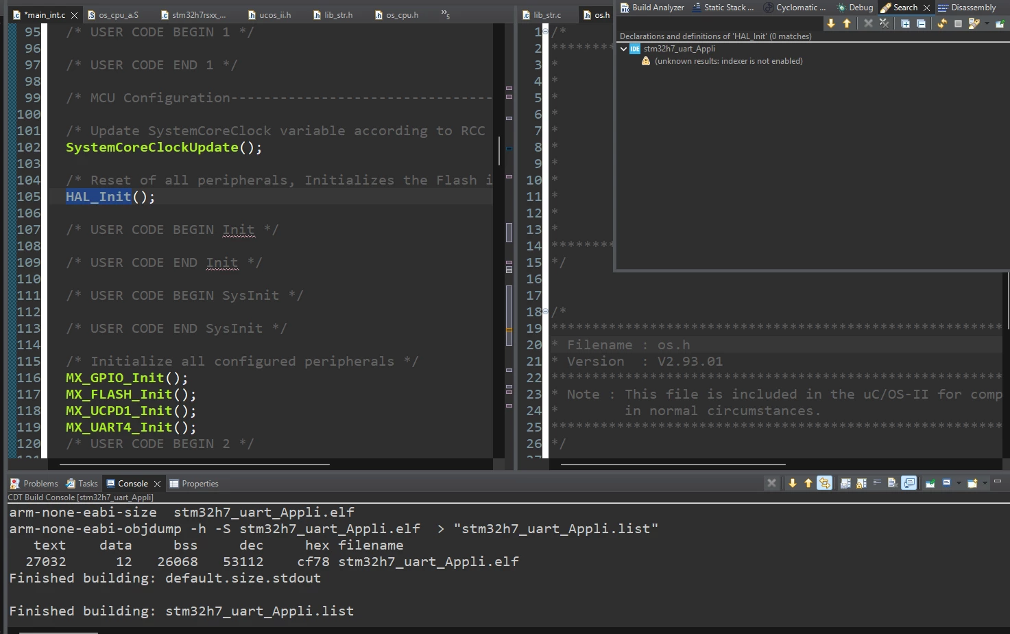

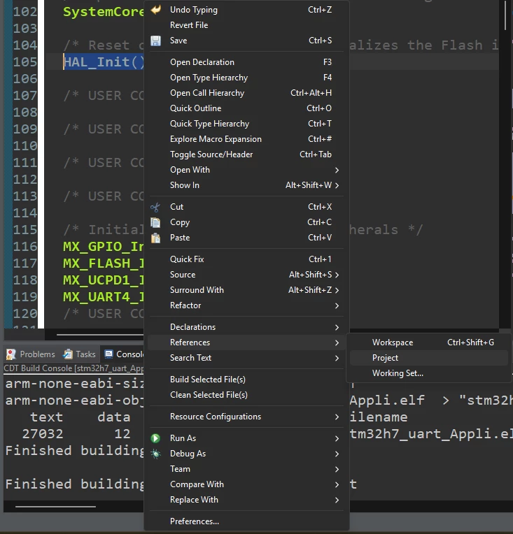

However, I finally found a possible culprit when Right-Clicking a HAL_Init( ) call within my code and clicking References > Workspace/Project.
A window should pop up and may relay the message “unknown results: indexer is not enabled”).
Window is in top right.
The solution for this lies in right clicking your project in Project Explorer and clicking Properties > C/C++ General > Indexer > Enable Indexer if the option is not checked. Applying this resolved the issue for me.
I copied and pasted my project from another one I made and am not sure if it disabled this option in the process, but it was a sneaky one since the project still compiles, executes, and lets you rebuild the index when you need to. Should be something ST should check out.
