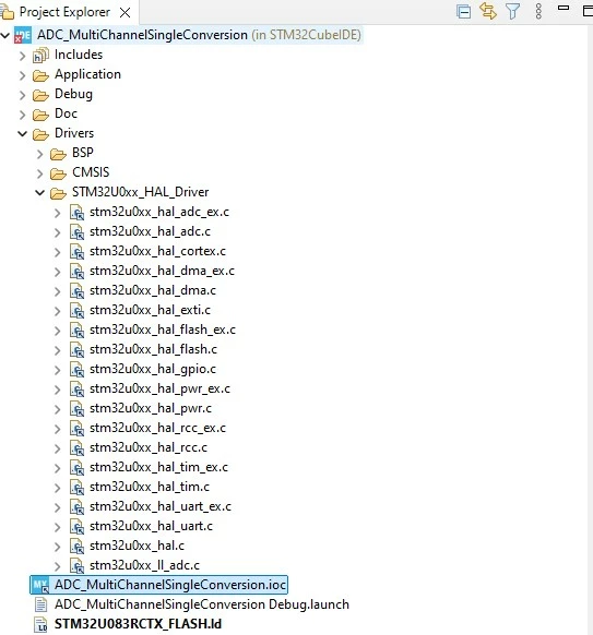

Auto Generate Project Fails to build after an IOC change
I am generating code using STM32CubeIDE 1.16.1
Example Selector
Board Name - NUCLEO-U083RC
ADC_MultiChannelSingleConversion
The code compiles and runs.
Any change then made to the IOC file appears to delete at 34 files one file is still needed - stm32u0xx_ll_tim.h
The compile error is shown below:

In file included from C:/Projects/1.16.1/ADC_MultiChannelSingleConversion/Src/main.c:24:
../../Inc/main.h:35:10: fatal error: stm32u0xx_ll_tim.h: No such file or directory
 35 | #include "stm32u0xx_ll_tim.h"
compilation terminated.
make: *** [Application/User/subdir.mk:31: Application/User/main.o] Error 1

09:57:50 Build Failed. 7 errors, 0 warnings. (took 349ms)
If I copy the file back into the include directory the code build correctly.
The images show which files have been copied back.
Interestingly the GUI for the IDE is no longer showing the Inc directory, not sure if this is a setting issue or related. Also shown in the images.
1 reply
JorgieAuthor
Directory missing image now included:
