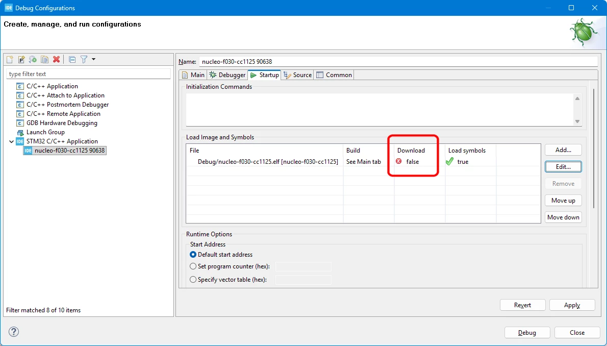

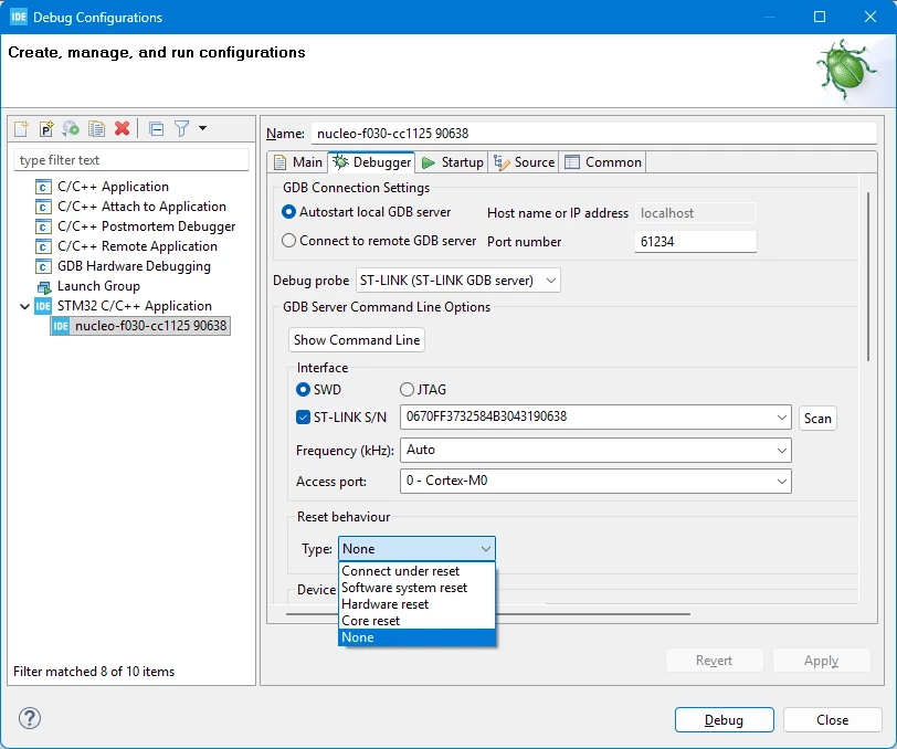

Create a Debug Configuration with 'Reset  behaviour' set to 'None' and 'Download' disabled:
#AttachToRunningTarget
