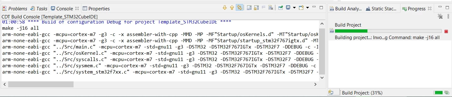

assembly file works in keil but not working in stm32cubeide !
I have an assembly file which contains something like :
		AREA |.text|, CODE, READONLY, ALIGN=2
		THUMB
		EXTERN currentPt
		EXPORT SysTick_Handler
		EXPORT osSchedulerLaunch
;some code here
ALIGN
END
which compile and work in keil . but when I put this file in stm32cubeide it will go to 31% for compiling and then will stop :
0693W00000AMI5rQAH.jpgWhat Is The Problem :expressionless_face: ?

>>What Is The Problem?
GNU/GAS has an entirely different syntax?
Why make fails, hard to know.

So what should I do ? any reference about this differences and how to change them to work ? any example ?

find out by adding these:
.syntax unified
.cpu cortex-m7
.fpu softvfp
.thumb
and changing function to something like this :
.section .text.osSchedulerLaunch
 .weak osSchedulerLaunch
.type osSchedulerLaunch, %function
it will compile if I remove "Systick_Handler" part of my assembly file the systick part is :
SysTick_Handler:
 CPSID I
 CPSIE I
 BX LR
what should I put before this function to get to work . ( when I add function attribute like osSchedulerLaunch it will hang on compiling again )
