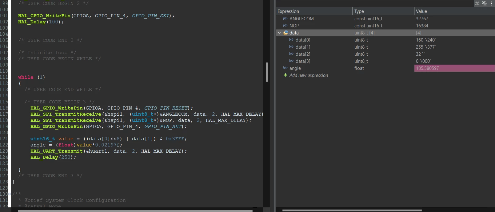

AS5047 SPI live expression not updating
I'm writing a code for getting angle from a AS5047u magentic encoder to get the angle but the value from the angle not seems to be updating in the live expressions
    kavinkumarBest answer
    September 6, 2024
    	uint16_t spi_RX=0;
    	HAL_GPIO_WritePin(GPIOA, GPIO_PIN_4, GPIO_PIN_RESET);
    	HAL_SPI_Transmit(&hspi1, (uint8_t*) &COMMAND, 1, 100);
    	HAL_GPIO_WritePin(GPIOA, GPIO_PIN_4, GPIO_PIN_SET);
    	HAL_Delay(1);
    	HAL_SPI_Receive(&hspi1, (uint8_t*) &spi_RX, 1, 100);
    	uint16_t ANGLEUNC = spi_RX & 0x3FFF;
    	enc.m_angle = (float)ANGLEUNC * (360.0f / 16383.0f);
    	enc.spi_RX = AS5047U_ANGLECOM;
    this is the code that worked for me if you're using AS5047 you should receive the data in the second call

    Both data[] and angle are not updating or just angle?
    September 2, 2024

    kavinkumarAuthorBest answer
    September 6, 2024
    	uint16_t spi_RX=0;
    	HAL_Delay(1);
