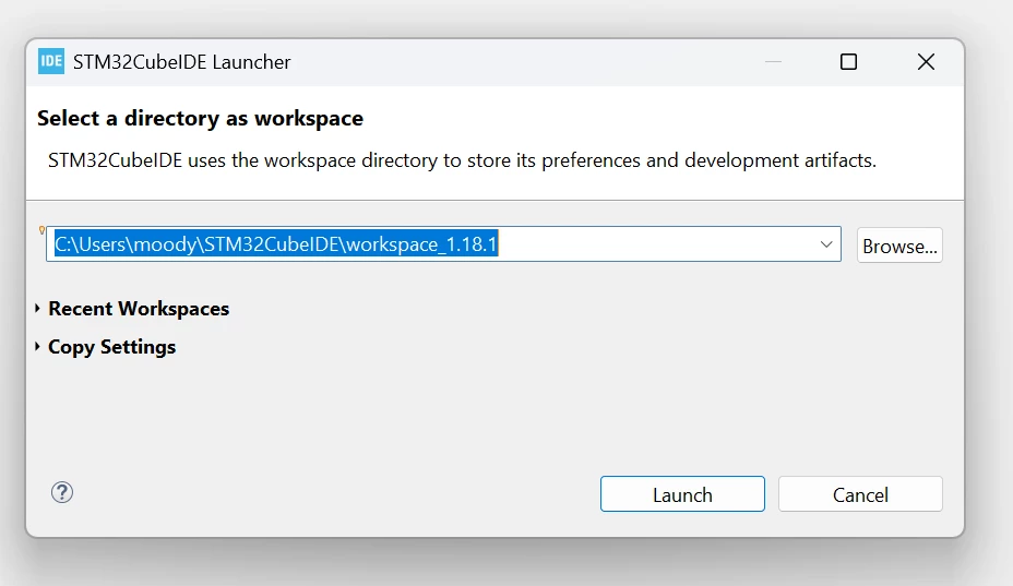

The problem is bigger than I thought ... cubeMX loads the files into what it thinks is a workspace ... but IDE opens another workspace which it gets from cubeMX .. huh ... when I switch the IDE to the MX workspace I get a inconsistency message ... huh.

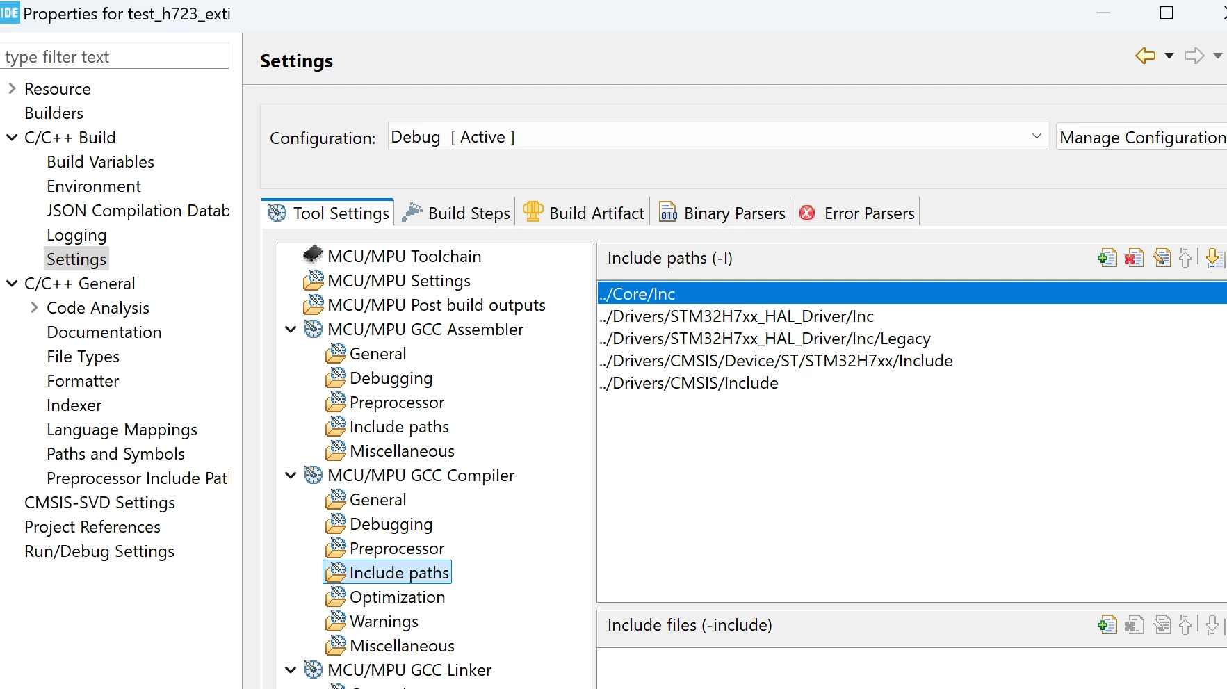

Aug 10, 2025 1:25 PM UTC
Include paths are in project properties:

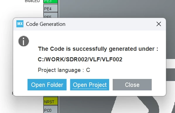

Aug 11, 2025 12:51 AM UTC
Thanks for your reply TDK ...however
this is the result of "generate code" in MX
... and when I press open project.

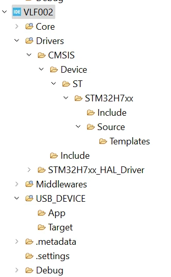

cubeIDE opens my default workspace below ..
BUT.... the project file heirarchy is there but contains no generated source files ...
the files are actually  in the MX directory above.

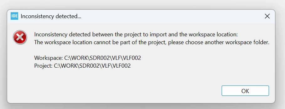

when I try to set the IDE workspace to where MX actually put the files ... I get the workspace conflict error message.
But if i try to compile the "empty" project in from the IDE it does compile ( with the arm_math.h error message).
