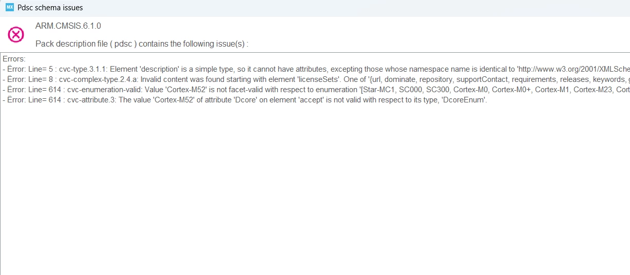

ARM Cmsis 6 support in STM32CubeIDE
I tried installing ARM Cmsis 6 Pack with STM32CubeIDE 1.16.1. It is having errors. I'm attaching the screenshot below -
Though ARM Cmsis 5 is working fine.!

    If you're not using the latest version of STM32CubeIDE or CMSIS packs, try to update it.
    AVerm.4
    AVerm.4Author
    September 23, 2024
    Cmsis pack is not required. It is integrated in CubeIDE.
