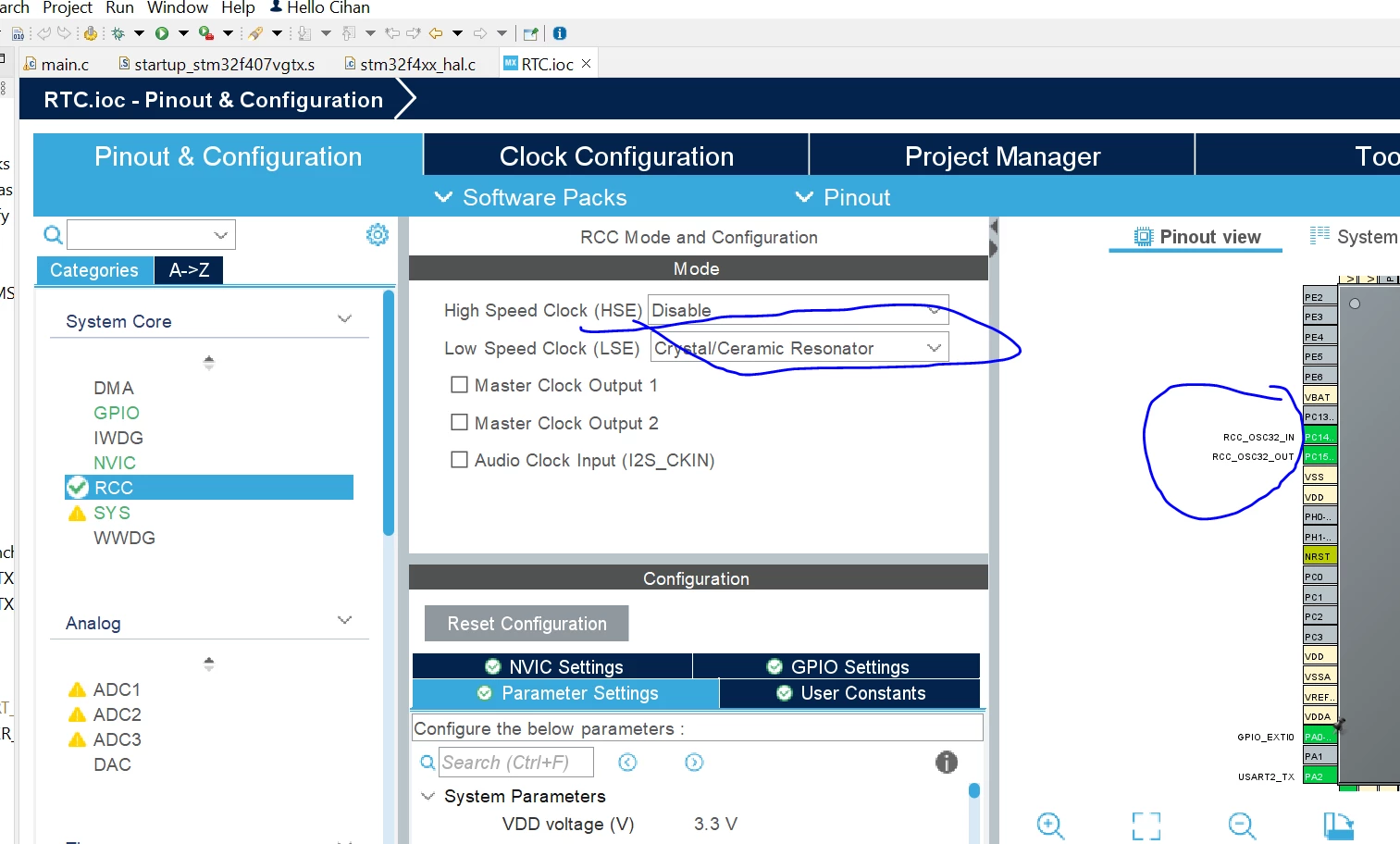

application is stuck at SystemClock_Config() and MX_RTC_Init().
I have debugged my application and came to know, there is problem at SystemClock_Config(); yet I do not know what the issue, please see clock configuration in below as well.
I have also commented out SystemClock_Config() and debugged again, this time error_handler() is called aat MX_RTC_Init() function.
I suspect that, there is something wrong with my clock configuration, I just can not see what that is.
When I commented out MX_RTC_Init() function, the application runs flawlessly. Thus, after debugging I made it sure that the problem is with initialization of both system clock and RTC.
I hope I have made the topic clear, else please let me know for further information. Thanks for the support, much appreciated.
I have though that LSE (32.78kHz) is already inside the board. So, if I am mistaken then it might be the root cause.
Could you please help me resolve ?

MM..1
MM..1Best answer
Mar 23, 2024 3:46 PM UTC
Check your board , i mean LSE is not placed on it. Then simply disable LSE and enable LSI for test
