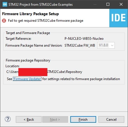

Anyone know how to resolve a "fail to get required stm32cube firmware package" error when importing a new project?
I tried importing a project using STM32CubeIDE V1.4 and got the following error:
I tried doing package updates and everything I could think of but I wasn't able to figure out how to resolve this (tried googling/forum searching it but no luck). Anyway, if anyone has any suggestions, that would be awesome. Thanks!

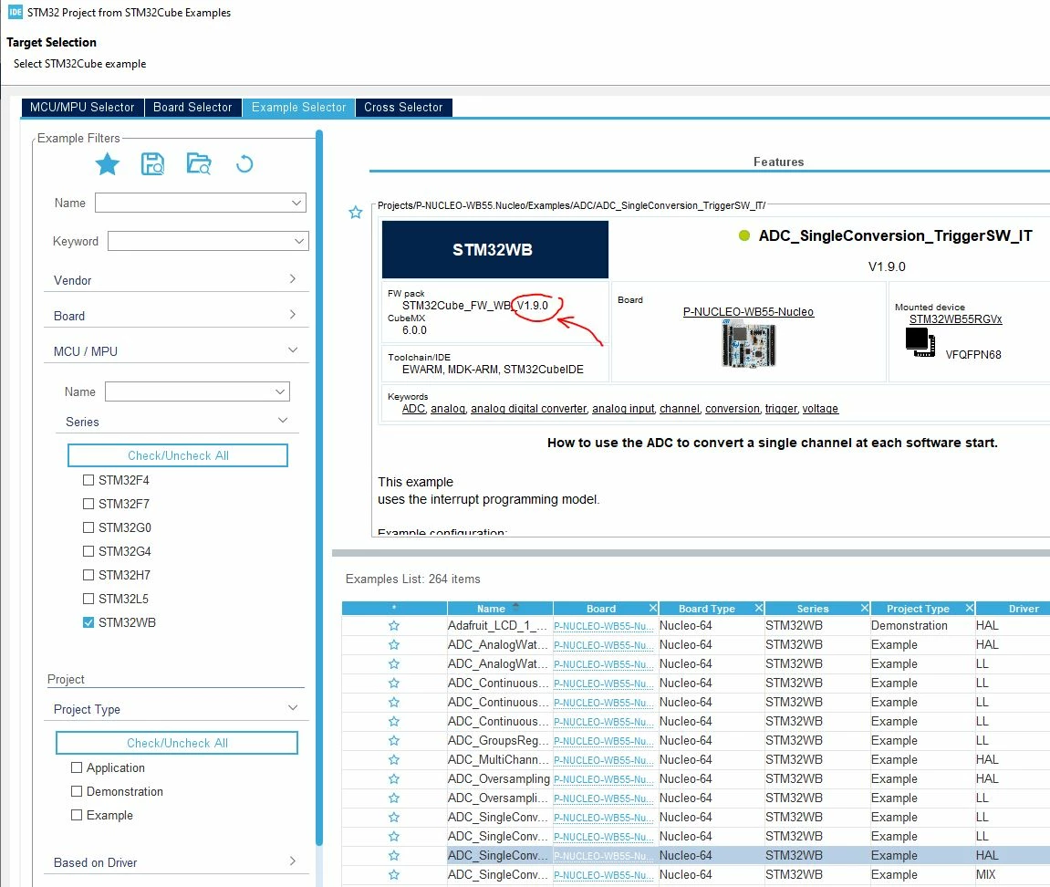

Weird stuff is selecting a WB example 1.9.0 pack is required:
But such 1.9.0 pack sounds unknown
I guess @ST has to get a look at ...

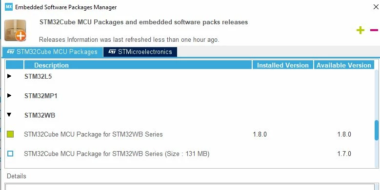

I think this may have something to do with the STM32WB packages.
I've encountered the exact same issue. I just tried refreshing the Embedded Software Packages and V1.9.0 finally showed up and can be installed (Help -> Manage Embedded Software Packages -> Refresh).
I can now import examples again. I suspect this was indeed something ST had to fix on their side.

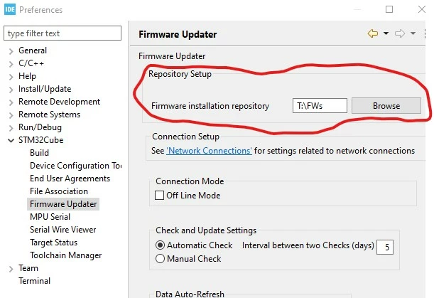

Good if solving issue. Myself I've got a try on my running environment. If destination directory does not exist STM32CubeIDE is creating it for me prior adding FW material. Any destination repository write permission issue ? Be aware there is some default but you can update by yourself destination directory.
