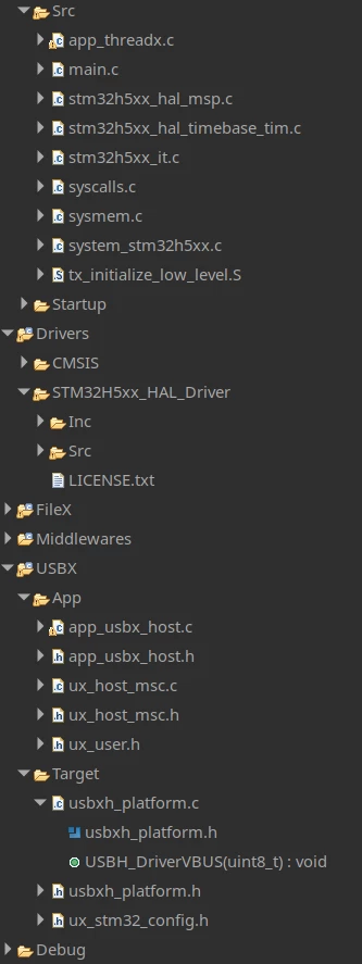

And the only existing example is made only for IAR , not easy to get it to stm-IDE in any useful way.
So i tried now a new simple project: just use USB-MSC , to connect a USB-stick -- to see, whats missing , to get it activated in my usb-audio-host.
But surprise, not working...out of the box. :)

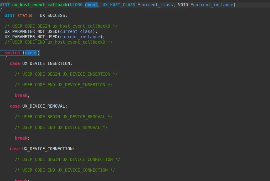

see: this its usb handling:
yes, really doing nothing. perfect tool.

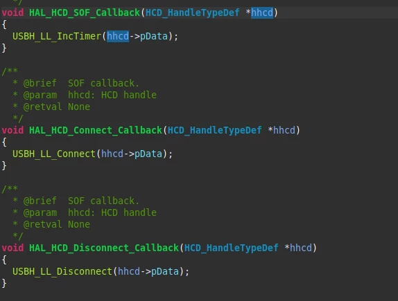

in old times, with fatfs and "simple" usb lib, on H743 i did usb-msc-host, working really:
in my simple understanding of such complex thing, as connecting an usb-stick , this old MX generated code did something useful, the new "improvement" with Azure/rtos i just dont understand - for my small brain it just looks like people with no brain at all working here to do the best they can.

+ USB host -> for ?  I did msc here, but more audio host i want to run - and got it running.
USB MSC host "did nothing" (as on first post shown), usb stick insertion empty;
here i had to put in this :

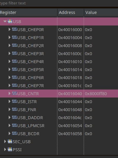

in all these files with very informative and creative names i cannot find, where the hardware is set to useful state:
the usb registers just stay at this state without any change :
