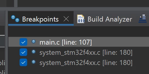

Another BUG. Can not remove breakpoint(s)!
In STM32CubeIDE Version: 1.16.0 can not remove the breakpoints:
Not by "Run/Remove All Breakpoints", not by "Toggle Breakpoint".
Hard to see - is breakpoint set or not!
Menu item "Remove Breakpoint" is missing!
How to get around this bug?

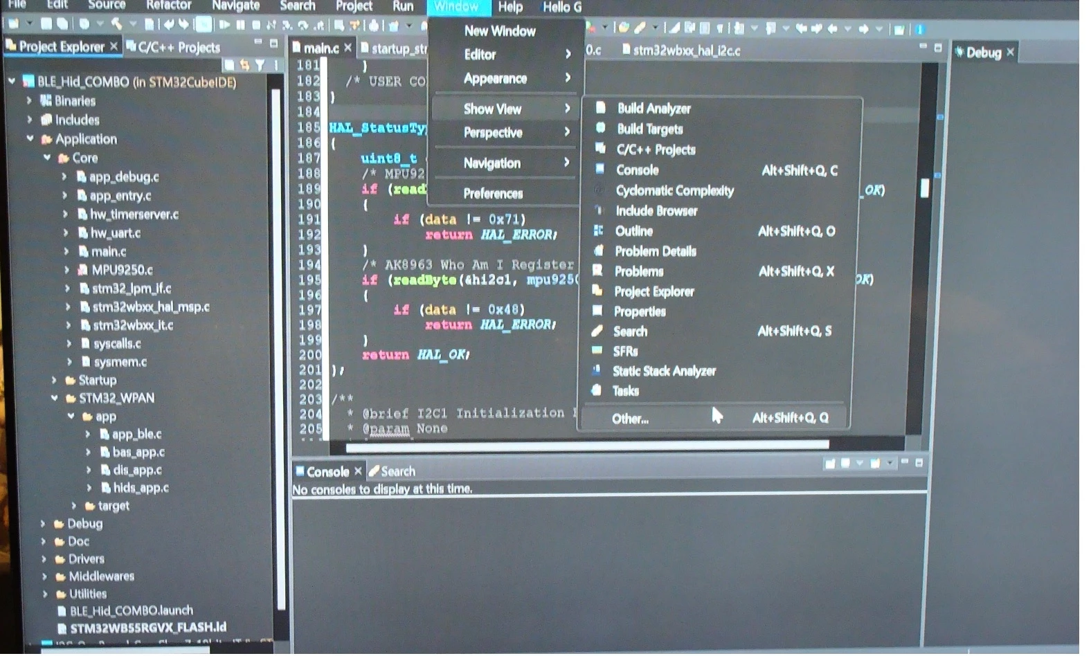

TDKBest answer
August 28, 2024
Window -> Show View -> Other -> Breakpoints
10 replies
August 28, 2024
Open the breakpoints tab. Right click to remove a breakpoint.
If that's not working, show screenshots of what's happening on your side.

Thank you TDK,
How to get to breakpoints tab?

Sorry, find under Debug: Window -> Show View -> Other -> DEBUG --> Breakpoints
and thanks was able to remove all !
GS2Author
Senior
August 28, 2024
Again, all breakpoints are removed, but debug breaks on the same old points!!!
