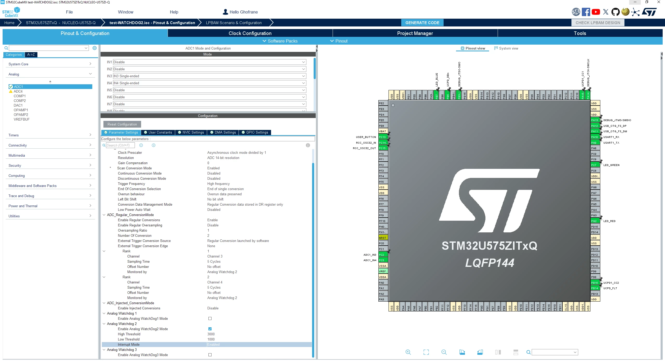

I have a project on Nucleo board with STM32U575ZIT6Q. I'm using STM32CubeIDE version 1.16.0 and CubeMX version 6.12.0. My .c and .h files are generated separately per peripheral.
I was faced with an issue that watchdog works only with one channel.
My analog watchdog settings:

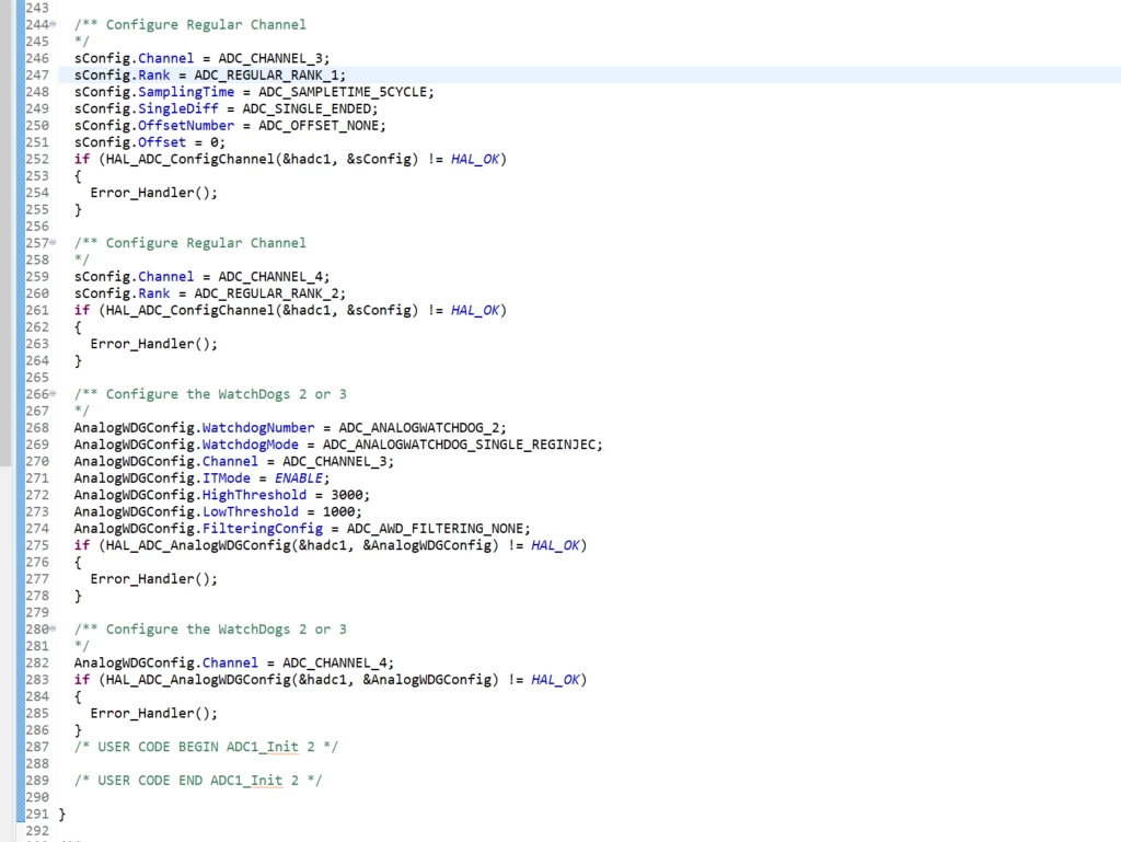

After generating code, ADC file shows:

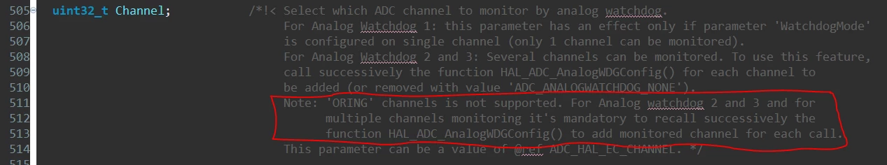

When I was investigating, found this comment in stm32u5xx_hal_adc.h file, ADC_AnalogWDGConfTypeDef structure definition:

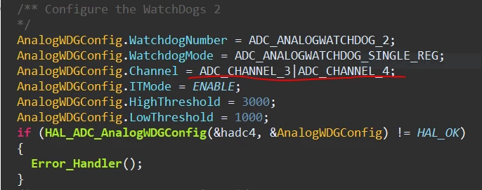

After applying what is mentioned in the comment, watchdog works on both channels.
Please fix this configuration bug. Thanks.

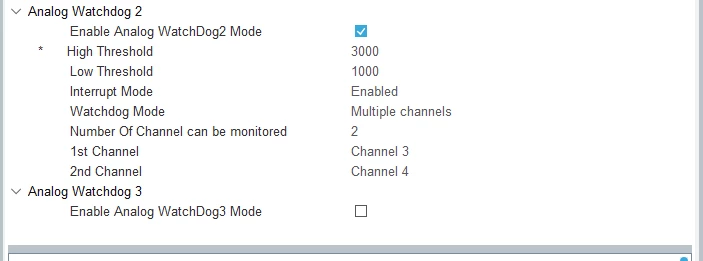

Hello @S-E
After using CubeMX 6.12.0 and try to reproduce the issue mentioned above , this is what I got  after generating the code :
I am sharing with you my IOC
Would you mind sharing your OS and indicating if you have installed CubeMX 6.12.0 from the ST official site or used the update option?
THX
Ghofrane
