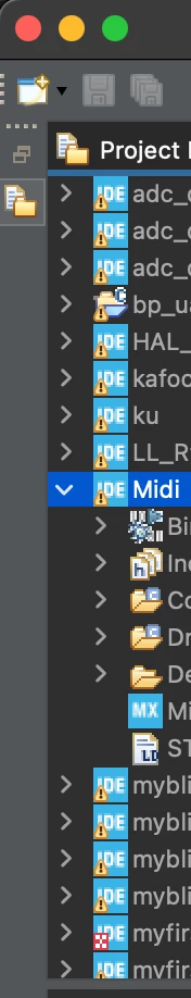

Suddenly all my project icons in the project are tagged with a yellow (exclamation mark) icon.
Why? This is ugly and I don't see any other item marked when I open the tree view.

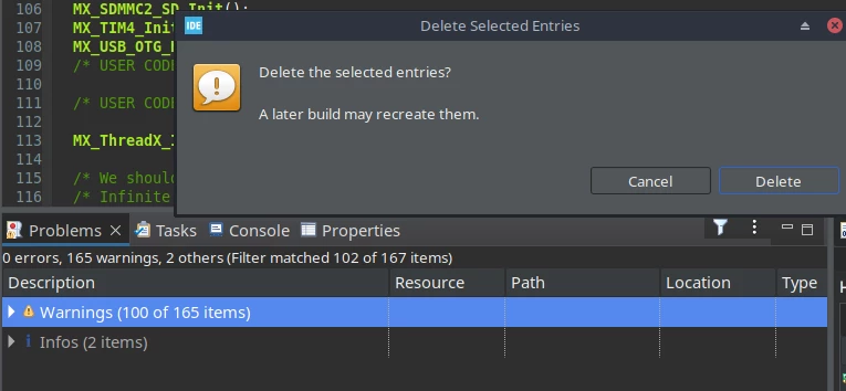

    maybe the basic setting , which errors are shown, is different now...
    try first to delete collected old errors (right mouse click on warning/erros -> delete) , see:

    I don't see any errors or warnings in the Problems view (like in your screen shot).

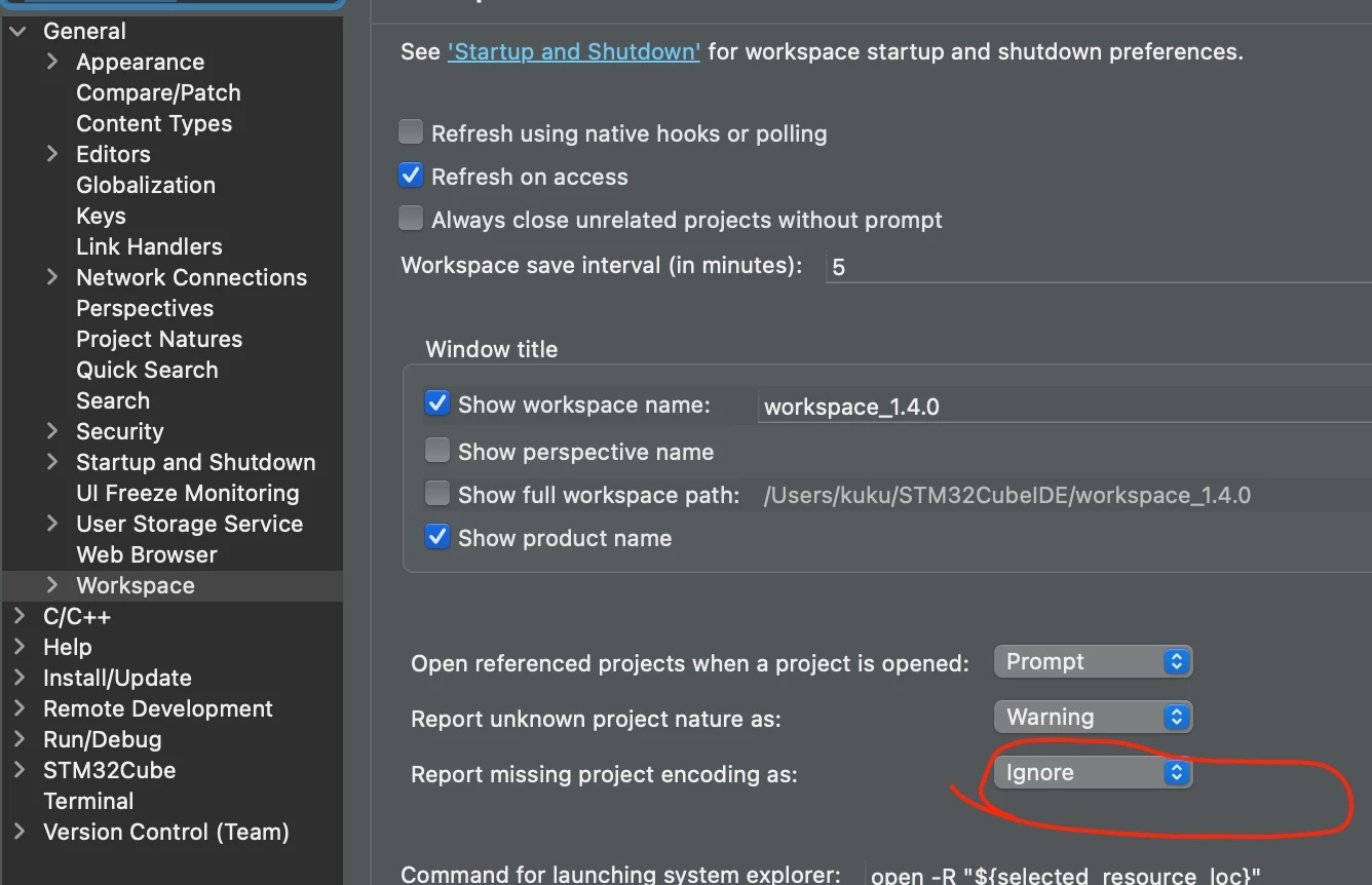

    EDIT: Your post made me think of it and I looked into the workspace settings and changed "Report missing project encoding" from "warning" to "ignore" and this made the /!\-icons go away.
    So is there something new to the "encoding" of a project? What does it mean? Text encoding (UTF-8)?

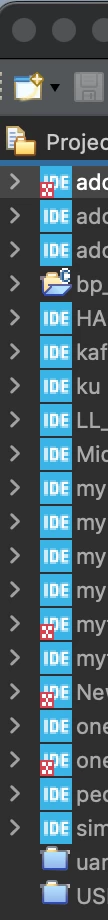

    Result:

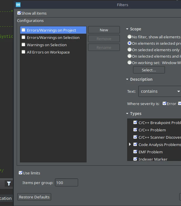

    so maybe -> set Problems -> filter (click the filter symbol) + enable...

    No, doesn't make them appear. I consider the issue solved though, since the i-icons have disappeared.
