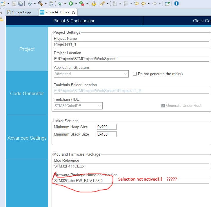

After the last update STM32CubeIDE to 1.4.1 the SD card stopped working on STM32F4...
The bundle FreeRtos+ FATfs stopped working. In version embedded software 1.25.0 and 1.24.. When I trying to call f_mount() the system freezes completely. I took two days to find the problem! In file sd_diskio.c (FATfs) queue function is called (osMessageQueuePut) from the interrupt. This leads to a complete system crash. Even I, after two weeks of studying STM, know that you cannot call a queue from an interrupt!
I had to replace the sd_diskio.h and sd_diskio.c files with files from version 1.23. There, instead of a queue, the usual flag is applied. After that, everything worked. But the files are replaced after each generation with a cube.
Questions:
Is it generally normal that after the next updates everything collapses due to children's mistakes?

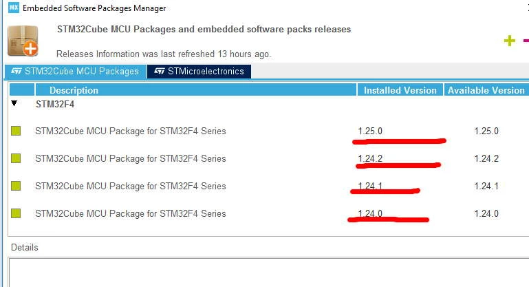

How can I manually select in a cube not the latest version of embedded software? This tab is there but it is not active despite the fact that many versions have been downloaded.
