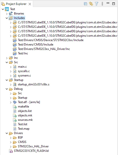

Adding folders to Include Directories are showing up empty. How do I fix this?
Trying to get started with a Nucleo board and STM32CubeIDE. I added directories via Paths and Symbols under Includes, however, the folders/directories (STM32C0xx Include, CMSIS Include, HAL Driver Inc) show as empty in the IDE. How can I fix this?

With Paths you can add any folder(s), those are not neccessarily project folders. Just info for the compiler/linker command line.
Where is the project/folder structure from?
If you start with a new STM32 project using STM32CubeMX, you should get a clean project and folder tree.

I would like to see the .h files that are in the STM32C0xx/Include folder listed in the IDE. Currently, it is showing as an empty folder.

If you mean the item "Test/Inc" under Includes - it doesn't expand likely because of Eclipse bug. I've tried several variants but could not make it expand. Just another bug, not a big deal.
The files should be visible under the 3rd folder, "Inc".
Of course you can fix this if you are motivated enough. Eclipse is open source.
