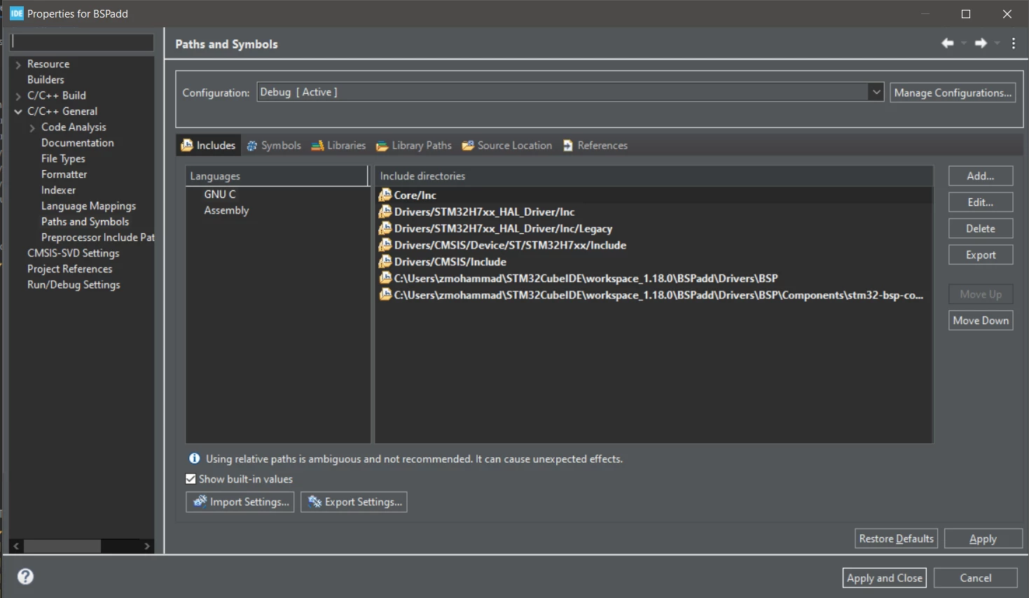

I need to add the BSP libraries for the STM32H735G-DK board to enable display functionality. I have downloaded the STM32CubeH7 package and navigated to the Driver folder, where I selected my board and found the necessary BSP libraries.
However, when I open STM32CubeIDE, go to Project Properties → C/C++ General, and attempt to add the BSP folder path, the IDE does not recognize the libraries. Instead, I only see the _htmresc file within the folder. Normally, when I open the directory manually, the libraries are present, but they do not appear within the IDE.

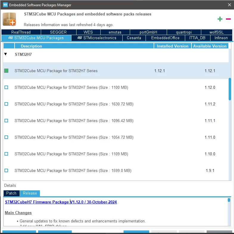

zaidmohaAuthor
Mar 10, 2025 8:09 AM UTC
Hello @KDJEM.1 , I really appreciate your availability, but i checked, and it shows me that the packages are already installed.stm32.PNG
KDJEM.1
Mar 10, 2025 9:18 AM UTC
Hello @zaidmoha,
Thank you for updating this post and glad to know that the STM32CubeH7 is already installed.
Now, I recommend you to refer to my replies and the steps shared in my comments to add the BSP drivers.
If you get any build error, please don't hesitate to share the error and your project.
Thank you.
Kaouthar

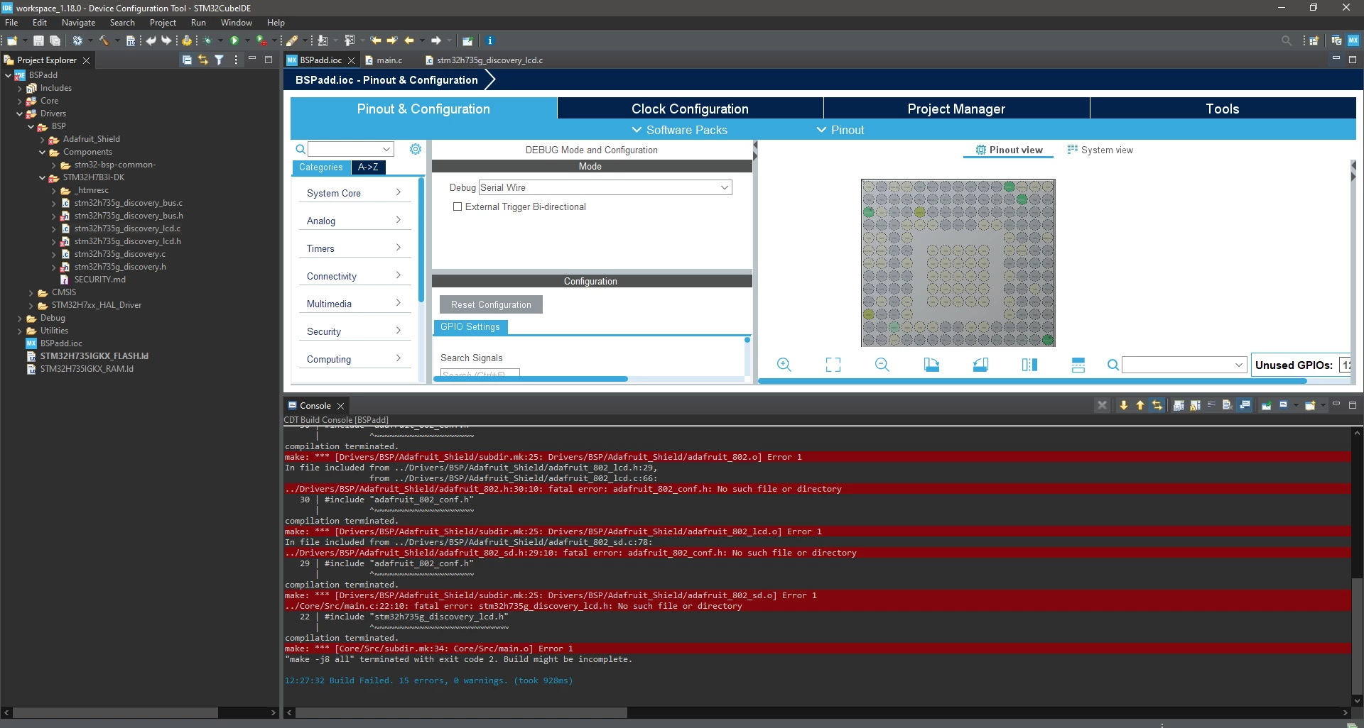

zaidmohaAuthor
Mar 10, 2025 11:29 AM UTC
KDJEM.1
Mar 10, 2025 11:51 AM UTC
Hello @zaidmoha;
Please share your project, as I mentioned in my latest reply.
Make sure that you add the include paths for BSP drivers.
Thank you.
Kaouthar

Mar 11, 2025 11:36 AM UTC
Hello @zaidmoha,
You can compress your project on format .7Z and drag and drop to add your project.
I made some test and I'm able to add BSP drivers. Please follow these steps in the below to add BSP drivers:
1- Open STM32CubeMX, click on “access to board selector” and choose "STM32H735G-DK" board.
2- Click “yes” on initialize all peripherals with their default mode.
3- Enable DMA2D
4- Click on project manager and generate code:
5- Create a BSP folder in your project as shown in the below figure:
6- Copy Components and STM32H735G-DK folders from STM32Cube\Repository\STM32Cube_FW_H7_V1.12.1\Drivers\BSP to \BSP\Drivers\BSP
7- In the Components folder keep these folders
8- In STM32H735G-DK keep these files:
9- Rename files
Old file name New file name Location
ft6x06_conf_template.h ft6x06_conf.h \BSP\Drivers\BSP\Components\ft6x06
ft5336_conf_template.h ft5336_conf.h \BSP\Drivers\BSP\Components\ft5336
gt911_conf_template.h gt911_conf.h \BSP\Drivers\BSP\Components\gt911
mx25lm51245g_conf_template.h mx25lm51245g_conf.h \BSP\Drivers\BSP\Components\mx25lm51245g
s70kl1281_conf_template.h s70kl1281_conf.h \BSP\Drivers\BSP\Components\s70kl1281
stm32h735g_discovery_conf_template.h stm32h735g_discovery_conf.h
\BSP\Drivers\BSP\STM32H735G-DK
10- Open mx25lm51245g_conf.h file under \BSP\Drivers\BSP\Components\mx25lm51245g and add:
#define CONF_OSPI_DUMMY_CYCLES MX25LM51245G_CR2_DC_6_CYCLES
11- Open mx25lm51245g_conf.h file under \BSP\Drivers\BSP\Components\mx25lm51245g and change:
#include "stm32xxxx_hal.h
 By
#include "stm32h7xx_hal.h"
12-  Open s70kl1281_conf.h file under \BSP\Drivers\BSP\Components\s70kl1281 folder and change:
By
13- Add these paths as shown in the below figure:
You can find my project test in the attachment.
Thank you.

zaidmohaAuthor
Mar 11, 2025 3:22 PM UTC
hi @KDJEM.1 , Here, I'm sending you the project. It gives me the same error, and I don't know why.
KDJEM.1
KDJEM.1Best answer
Mar 12, 2025 8:01 AM UTC
Hello @zaidmoha;
For you project bsp32, I tested and you missed step4 "generate code" after enabling DMA2D.
Also for step 8, you forgot to keep "stm32h735g_discovery_errno.h" and "stm32h735g_discovery_conf_template.h"
For step9, you messed to change the name file "stm32h735g_discovery_conf_template.h" to "stm32h735g_discovery_conf.h"
Please use the same format for include path shared in step 13. it is recommended to use “/” and not the “\” in the paths.
I've corrected your project and you can find it the attachment.
Are you testing my BSP project? I think it is working well and the steps for including BSP drivers are all detailed.
Thank you for your contribution in STCommunity.
Please click on Accept as Solution on the reply which solved your issue or answered your question.
Kaouthar
