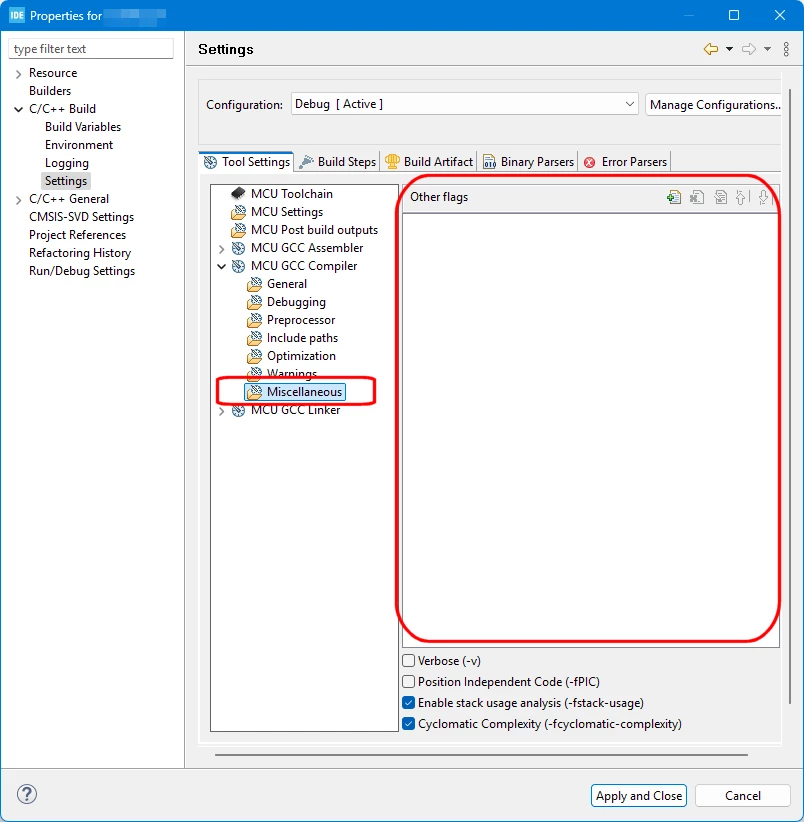

Since I have a yellow exclamation mark sticking at the project icon I would like to see if it disappears when I add the CFLAG:
--no-warn-rwx-segments
in the makefile. The Debug/makefile contains a bunch of flags but misses the CFLAG which I assume to be burried in one of the includes (makefile.init, makefile.defs). Only, I cannot finde these included files. Can anyone help?
And how can I find out about the reason for the yellow exclamation mark? I was used to find this propagating downstream in the tree view attached to other files. But I don't see any "smudged" file.

You can add flags in the Project settings Properties here:
If you hover your mouse over it, it should show the warning.
Also look in the Console output window.

Project Settings, name it better "Project Properties" - hard to find. Rightclick on the project in the tree view.
Click on Properties. The one finds C/C++ Build.
It's not in the Preferences menu item (macOS)
Indeed - post corrected
