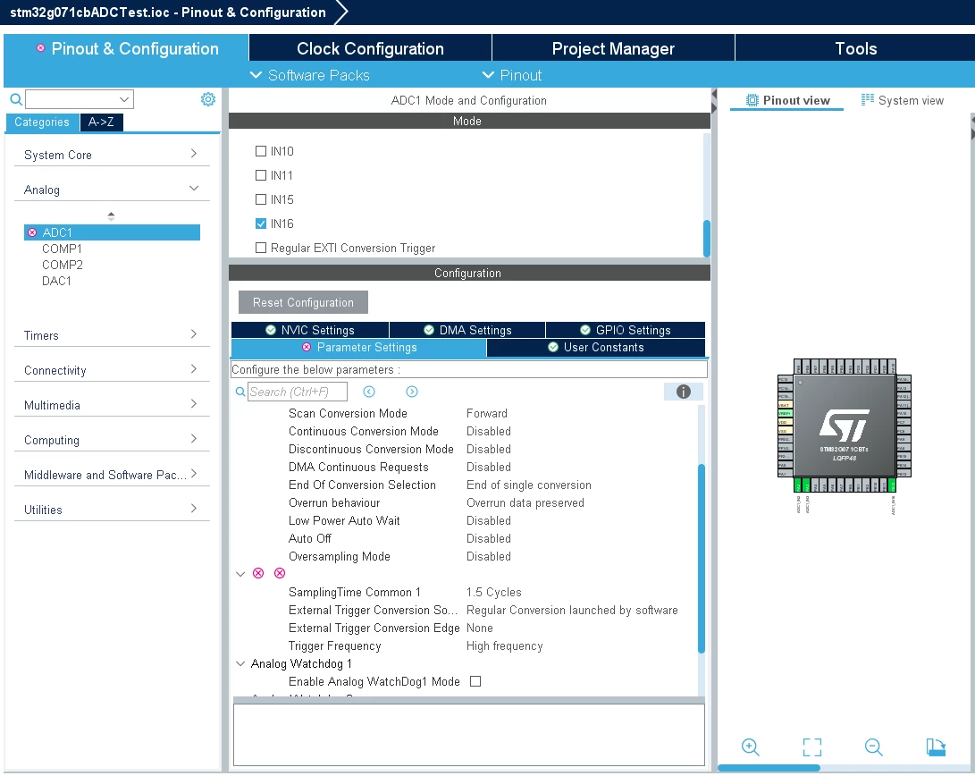

I am using the latest version v1.16.0 STM32CubeIDE with stm32g071cb.
It is not possible to use ADC1_IN16 (PB12). I have created also a new project  to test this condition.
Changing the sequencer disables IN16 or makes error condition.
I need PA2 -PA3 and PB12 pins (IN2-3-16 channels to ADC sampling)
Below attached screen view and the ioc file generated via STM32CubeIDE
Regards
Murat

    Jul 17, 2024 7:57 AM UTC
    Hello @istepne
    This issue has been reported in this post and it will be solved on the coming Cube Tools Releases.
    Update: this issue has been solved on the STM32CubeMX V6.13.0.
    Best Regards.

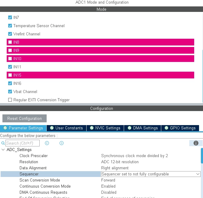

    Mar 21, 2025 8:31 AM UTC
    I am using the latest update Version: 1.18.0
    Stil it can not be changed as "fully configurable".
    Also I am using 9channels enabled DMA transfer and the transferred data order is not same as cahnnel selection.
    To get ADC sample on channel IN16, I have to choose "not fully compatible". And as a transfer result of the converted ADC value placed in order with In7-Temp-Vref-In11-Vbat-IN16 (not shown below)
    So, still some problems
