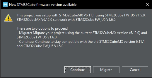

I have a project on Nucleo board with STM32U575ZIT6Q. I'm using STM32CubeIDE.
My ADC worked fine until i did this:
After migration HAL_ADC_Start function returns error.

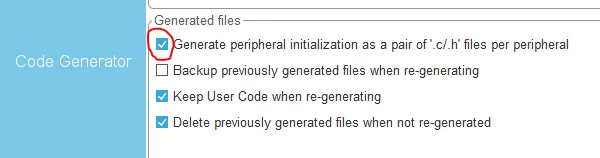

When I generate code I use this setting:
What is wierd, is that if I unselect this box, and generate code then ADC starts to work again!
Since I need to have those files separate I have to use previous Cube version.
Is there something I need to do or this is a SW bug?

    unsigned_char_array
    Lead III
    July 8, 2024
    Found the differences:
    main() is the same and calls all functions in same order
    both projects generate a warning about the SMPS when clicking generate, instructions unclear how to solve this
    MMTAppRegionsCount differers, the "ok" has 0 regions enabled and the "nok" version has 3 regions enabled in the ioc file, but I see no difference in generated code
    ProjectManager.CoupleFile=false in the ok version, true in not ok
    MX_ADC4_Init() is the same
    MX_GPIO_Init() is the same
    MX_ICACHE_Init() is the same
    HAL_ADC_MspInit() is the same
    HAL_ADC_MspDeInit() is the same
    HAL_MspInit() DIFFERS!
    Line "HAL_PWREx_EnableVddA();" is not generated!
    To me this is a bug. You can add HAL_PWREx_EnableVddA() in the user code section and that should fix it. Please let me know if that works.
    ST needs to be aware of this. Please add bug-report tag to your start post.
