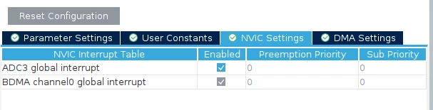

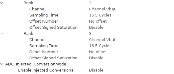

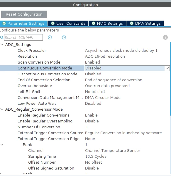

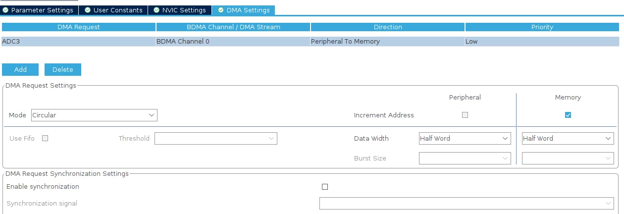

The CubeMX Mode and params are set up as:
and
NVIC settings:
with DMA settings:
Also Register Callbacks are set to enable for ADC.

    BDMA, DMA1 and DMA2 do not have access to the DTCM memory. BDMA has access to SRAM4 in D3 only. Please refer to the reference manual.

    Then I made another change that seems to have had some effect.  I changed the Overrun behavior to Overrun data overwritten.
    Now, I hit the break points at the first call HAL_ADC_Start_DMA(&hadc3, (uint32_t*)ADC.Raw, 3); followed by the second call HAL_ADC_Start_DMA(&hadc3, (uint32_t*)ADC.Raw, 3); five seconds later in the while loop after the tx_semaphore_get.  But then, running the program further generates no more interrupts and hence no more hits to the HAL_ADC_ConvCpltCallback (ADC_HandleTypeDef *hadc) routine.

    Setting the DMA to DMA1 fixes the issue.  Thought I had tried this before and failed, but I must have had other issues in the setup.
