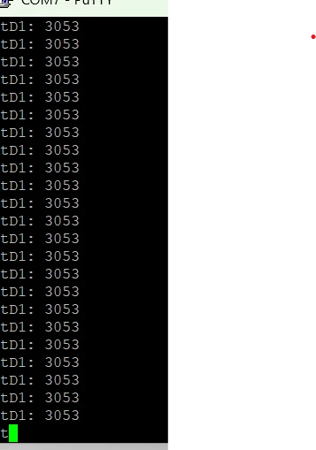

HI,
I am trying to get ADC read but the result is only the first read repeatedly even I change the voltage on ADC channel input it remains the same,

while(1)
HAL_ADC_Start(&hadc3);
uint16_t currentADCValue=HAL_ADC_GetValue(&hadc3);
sprintf(disp,"D1: %d\n\r",currentADCValue);
HAL_UART_Transmit(&huart8, (uint8_t*)disp, sizeof(disp), HAL_MAX_DELAY);
    TDKBest answer
    • Disable data cache, or manage it properly.
    • ADC data should be a uint16_t.
    • Wait for the ADC to be complete before sending out data. A small delay would be sufficient.

    while(1)
    HAL_ADC_PollForConversion(&hadc3,HAL_MAX_DELAY);
    That worked for me, with continuous mode disabled, but when I try to read two and continuous mode enabled and scan conversion mode enabled and with DMA to circular and full word setting I get only zeros.
