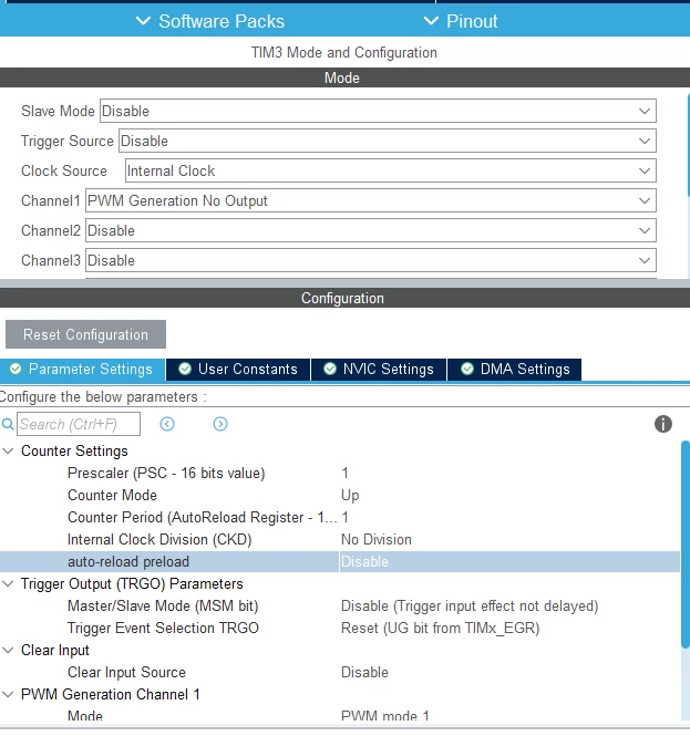

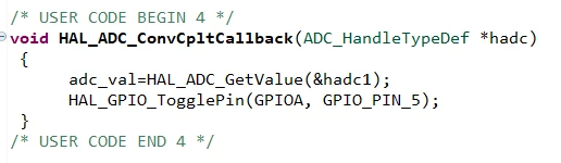

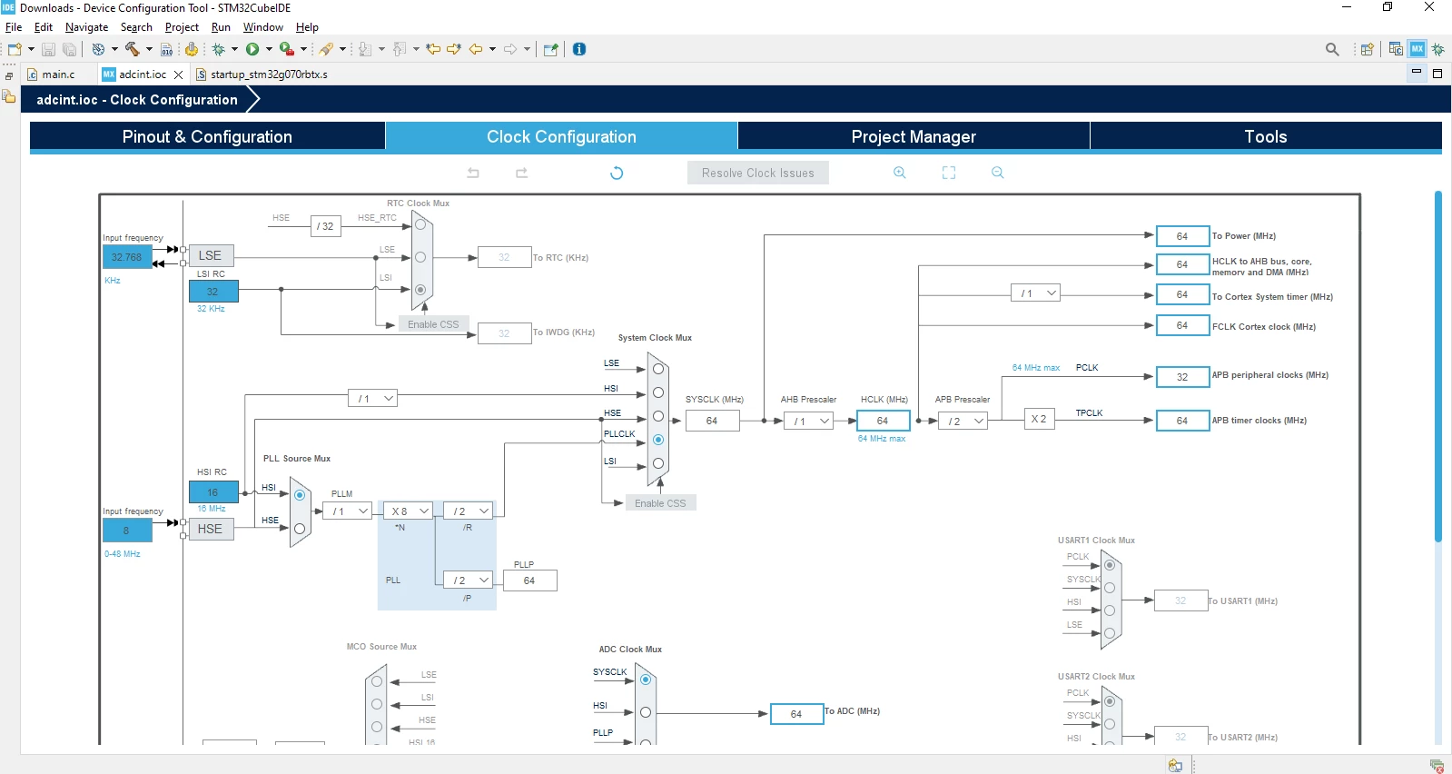

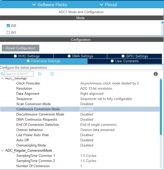

i want to do adc sampling at 10khz frequency in stm32G070RB i have attached the ioc file configration and code but adc sampling not working at 10khz frequency. let me know where i am doing mistake and how to solve this??

Hello @Pooja321
Actually using the latest version of CubeMX 6.9.2 standalone and CubeMX integrated in STM32CubeIDE1.13.2 I found a bug related to ADC clock mux that is grayed out even when I activated the ADC , this problem is reported to our dev team.
Internal Ticket number : 165233
Could you please provide the CubeMX version that you use .
