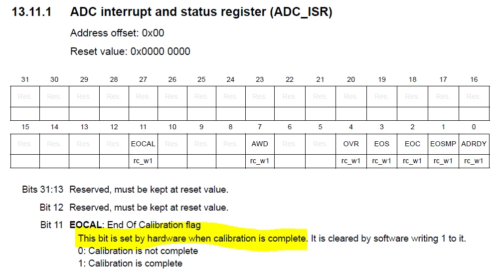

 Trying to calibrate the ADC at startup with the following code into the initialization procedure:
   ADC1->CR |= 0X80000000;      // calibration started
   while (!(ADC1->ISR & 0X800));   // waiting for the calibration to finish
 When compiled with Atollic, version 9.2.0, this code works perfectly. But when compiled with Stm32CubeIde, it gets trapped into the calibration command which never finish!

EOCAL is set at the end of the calibration. You're waiting until it's set. This is a race condition. So either the loop will immediately pass (if calibration isn't done yet), or it will never exit.
This is a software bug, not a CubeIDE issue.

if (ADC1->CR & 1) ADC1->CR |= 2; // ADC setup
 ADC1->CR |= 0X80000000; // ADC calibration started
 while (!(ADC1->ISR & 0X800)) { // waiting for the calibration to finish
 watchdog(); // macro to refresh the watchdog
 if (!--n) return FALSE; // failure exit
 ADC1->ISR |= 0X800; // clearing EOCAL
Do not use read-modify-write on ISR register and be careful with CR as it also has "rs" bits like ISR. Probably the most important - you are not waiting for ADDIS command to complete. And ultimately I would want the watchdog to act if the code gets stuck in that loop...

This clears ALL flags, not just EOCAL. This is covered in the reference manual (for STM32L0X0). To clear only EOCAL:
ADC1->ISR = ADC_ISR_EOCAL;
There are other requirements for starting calibration and you're not checking for them all. From the reference manual (for STM32L0X0):
The software is allowed to set ADCAL only when the ADC is disabled (ADCAL=0, ADSTART=0, ADSTP=0, ADDIS=0 and ADEN=0).

The calibration complete waiting has one more requirement. RM0451 section 13.3.3:
The ADCAL bit can remain set for some time even after EOCAL has been set. As a result, the software must wait for ADCAL=0 after EOCAL=1 to be able to set ADEN=1 for next ADC conversions.
After calibration ADC enable and conversion start cannot be done in a single operation. One must enable ADEN, wait for ADRDY and only then ADSTART can be set.
ADC1->CR |= 5; // ADC started
ADRDY: ADC ready
This bit is set by hardware after the ADC has been enabled (bit ADEN=1) and when the ADC reaches a state where it is ready to accept conversion requests.
There is nothing technically wrong with read-modify-write operations, just some of them are unnecessary and can be replaced with simple writes. Also the fact that code compiles successfully or even works with some compiler version with some settings, doesn't prove it's correct. The code ir correct only when it formally guarantees the required sequence of actions.
