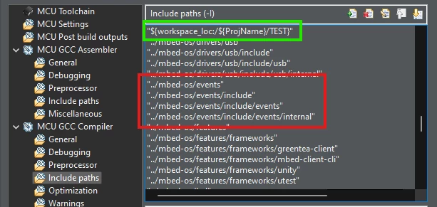

Hello, I am trying to add source files in my project, the folder is organized like this :
- events :
     |  - include :
     |      |  - events :
     |      |      |  - internal :
     |      |      |      |  - Some header files [A]
     |      |      |  - Some other header files [B]
     |  - source :
     |      |  -  .c and .cpp files
I copied the same path list to GCC asm, GCC compiler, G++ compiler :
When compiling i get "include not found" errors, i think it fails when including "folder/header.h" instead of just "header.h", but I am not certain.

I noticed that at the end of the compile command, there is this file mentioned :
"mbed-os/events/source/EventQueue.cpp_includes.args"
This file contains a list of inclusion arguments which look like what I'm including in the project properties, but the "events" folder is missing.
It is being refreshed at every compilation because if i modify it, it goes back to the initial state
I also added a "TEST" folder and added it to the included paths, and it does not appear either
What am I missing to give the compiler the correct paths ?
Thanks in advance
    Best answer by Toin
    Found the problem...
    For some reason, the events folder had specific build settings
    I found them by right-click on "events" --> properties, It had an old version of the project include paths
    Is there a toggle for folder specific settings ?
    I must have enabled them unknowingly :\

    Update : Some cpp files at the root of the project DO get the updated cpp_includes.args, but the source files in "events" do not

    That could also be a result of relative paths ...
    Yes, that's always the trouble with relative paths - you have to be sure what it's relative to !
    Hence best to stick to just the "header.h" form, and be sure to add the folder to the paths.
    ToinAuthorBest answer
    August 6, 2024
