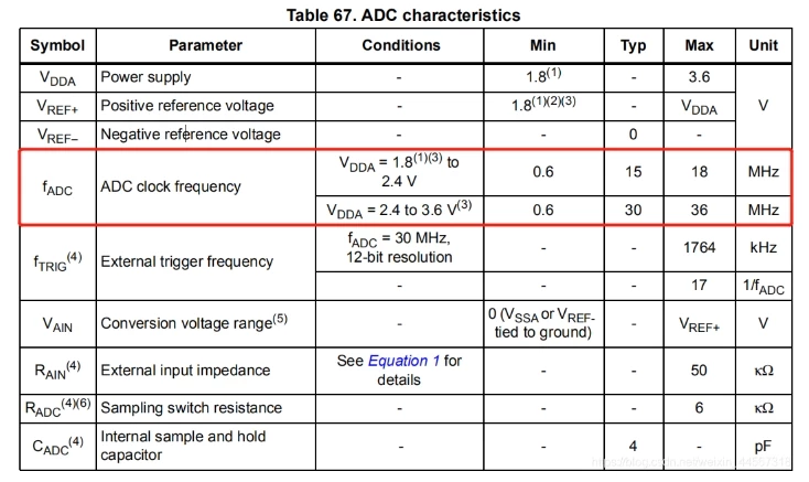

    How is that : (1) APB 1 peripheral: 36 MHz.
    Data sheet tels F429 runs  at 180 MHz. Have you mistyped F103?
    tasabaoAuthor
    September 28, 2024
    HI, thank you for your response.I made a mistake in the values; the APB2 is 72 MHz, and as shown in the figure, the maximum achievable rate is 36 MHz.
