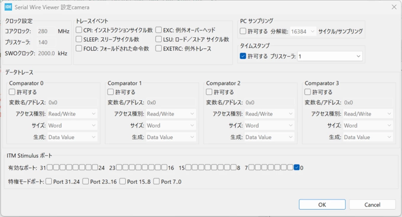

I am developing software using STM32CubeIDE on Windows.
I configured OpenOCD as the DebugProbe in the DebugConfiguration and ran the Debug process
Debug Configuration > STM32 C/C++ Application > BuildName > Debugger
DebugProbe -> ST-LINK (OpenOCD)
Serial Wire Viewer -> Enable: On

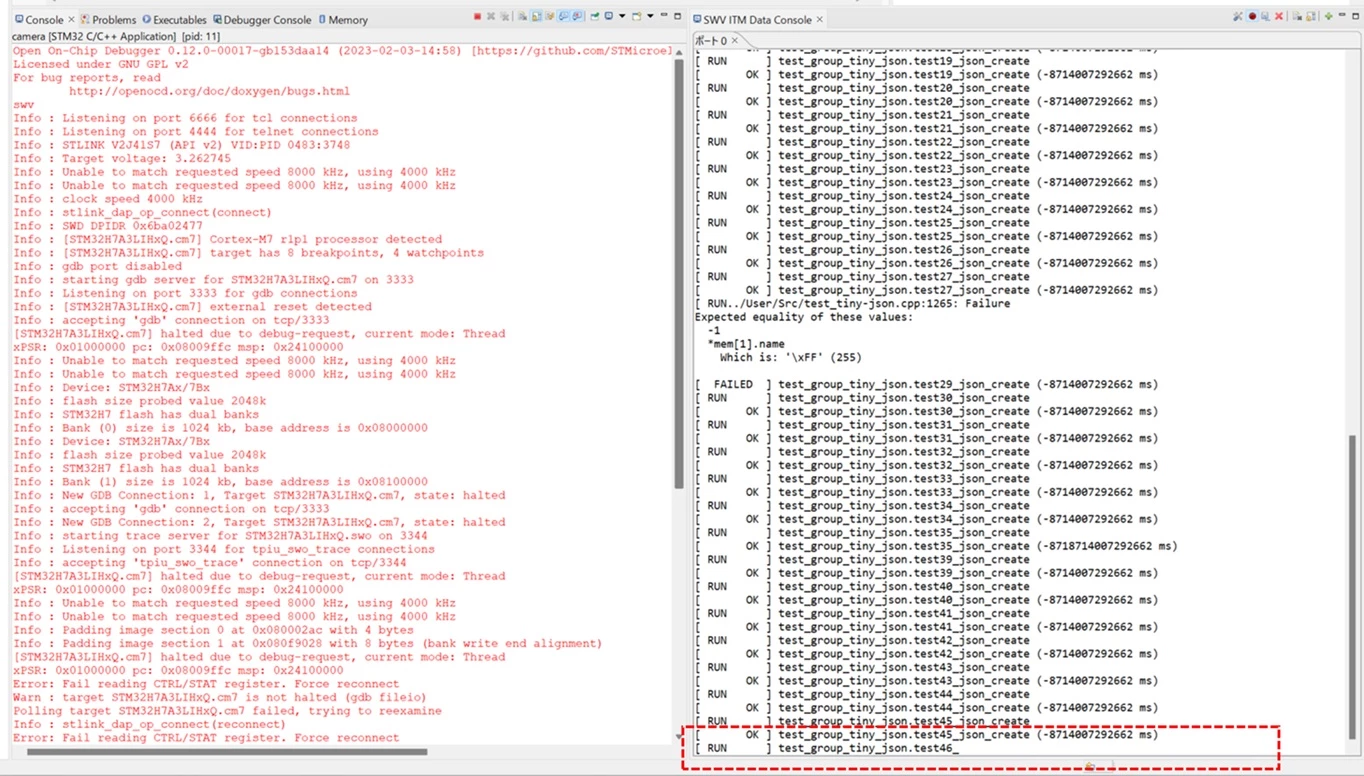

When capturing with SerialWireViewer during debug execution, the program ends unexpectedly, causing the results of the Google tests running within the firmware to be interrupted.
attached file: ConsoleErrorMessage.txt
image_error

SWV ITM Data Console

5 replies
