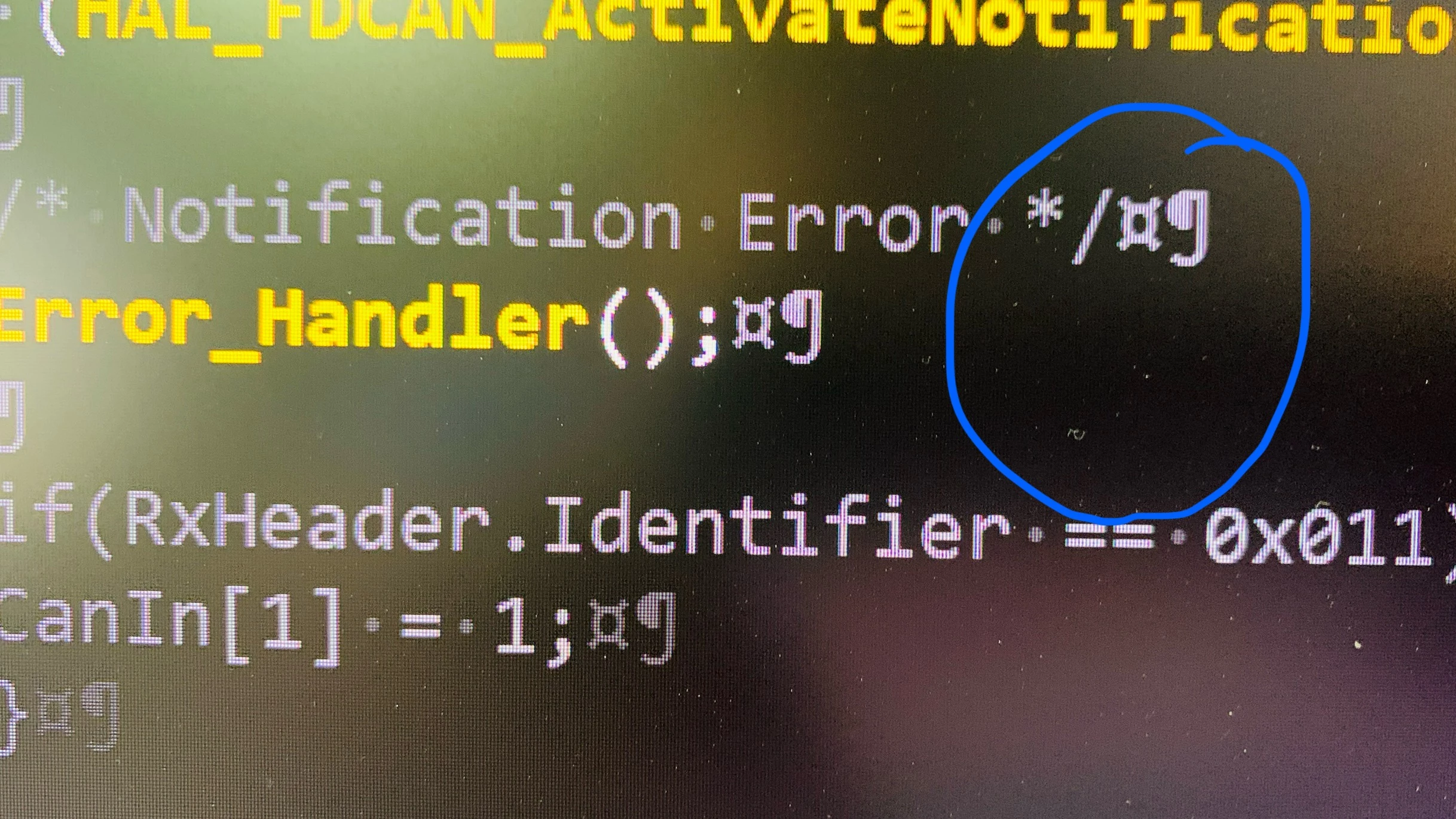

A strange set of letters at the end of the line.
After i generating code from cube MX
This symptom is after updating the IDE to version 1.14.0 and Cube MX version 6.8.1.
In circle from the picture I attached. Can it be fixed or Can it be reset?
Can compile normally But it disturbs the eyes.
Thank you in advance.

    Probably a "Display White Space" type setting in the configuration of the editor or screen view options.

    It works now, thank you very much for the advice. :thumbs_up:
