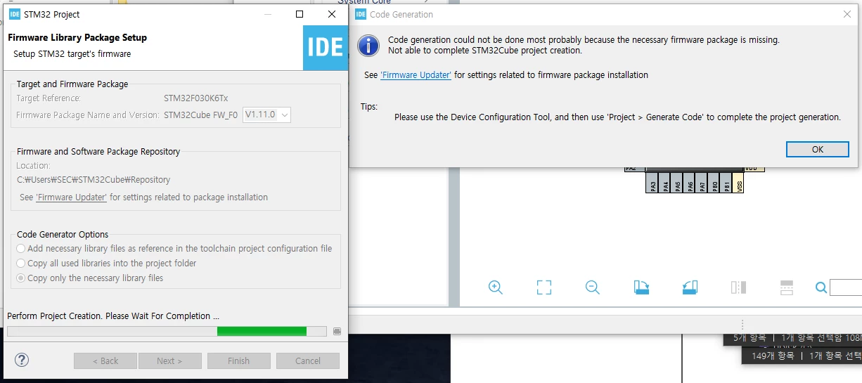

A code generation pop up will appear. Even though I got the latest version of the firmware package, it doesn't work.
0693W00000QOBsQQAX.pngI want STMF0 series project. How do i solve?

Peter BENSCH
August 22, 2022
Welcome, @YChoi.5​, to the community!
According to your screenshot, firmware version 1.11.0 was selected, which leads to the error visible on the right. However, the process can also be started if this version is not currently installed.
Are you 100% sure that under Help > Manage Embedded Software Packages > STM32F0 the version 1.11.0 is also marked as available?

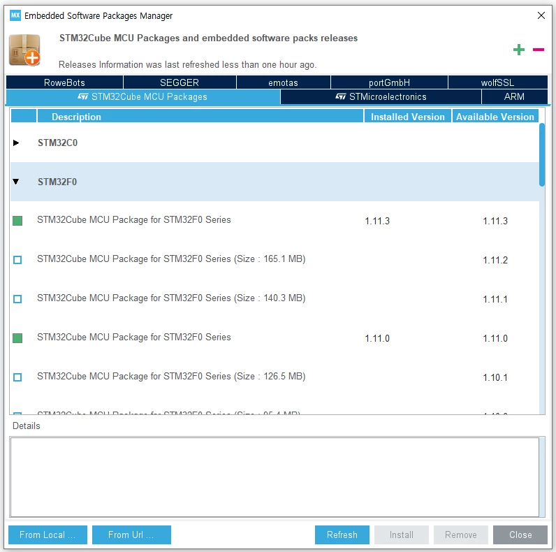

YChoi.5
YChoi.5Author
August 22, 2022
confirmed through this window. Project creation fails for both installed firmware versions.
thank you for reply. plz help me.​

Peter BENSCH
August 22, 2022
I have actually only seen such an error when someone had not installed the firmware or had not installed it correctly.
But there have also been reports of users not being able to import or open an existing project. Is it possible for you to generate a new project with the STM32F030K6 as a test?
